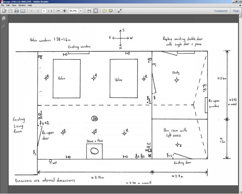

Hi! I currently live in the Scottish Islands and will shortly be converting the shed adjoining our house into extra living accomodation for our use. The shed is probably better described as a 'building' as about 26' x 13' internally, concrete floored, block and render walls and slate roofed.
Having spoken to the previous owner of the property there is a blocked-up door in the wall on which the shed adjoins our current living room, and this door has a concreet lintel. I am planning to re-open this doorway to save having to make a new opening and also re-open a blocked-up window at the end of the shed. This window appears to have a wooden lintel, but as it looks a bit rotten / wood-worm, I will replace this during the works. There are also two existing doorways (1x double width, 1 x single width) and one existing window in the shed that I will keep.
In the roof I plan to fit two large (1.4 x 1.38m) Velux solar-powered windows and a flue for the multi-fuel stove I hope to have fitted. The Veluxes will have 'light-tunnels' through the attic to allow all the light into the room.
Internally, the shed will be sub-divided into three room:
•new living room, with door into existing house, approx 16' x 13'
•study / computer room, with door into new living room and french doors to outside, approx 9' x 8'
•store room, not accessable internally but using existing single width doorway. This room will also provide access to loft space which will be full length and width minus the light tunnels mentioned above
I have spoken to the Council who have said they might require structural engineer's reports, architects plans and planning permission. They don't seem so sure and I don't know what I need to get so hopefully someone can help! We've got a budget of around £40,000 but we're also hoping to completely re-do the kitchen / dining room and bathroom and have a holiday out of this money.
Also, do I need architects drawings for this work of can I do drawings for the builder as there are no architects on the Island? I will post a sketch of the plans tomorrow as I am at work at the moment.
Thanks in advance, David
Anyone can draw the plans, though you want to get someone competent, if you can't access an architect then a technician or surveyor may be able to help. It is likely that the structural engineer will want CAD drawings to work from. If you can produce these then go ahead - (but know the buck stops with you).
When you say you spoke with the council, it sounds as though you spoke with the council building control department. They are separate from the planning department who are who you need to contact to see if what you propose falls within their remit - or if you have any particular restrictions which make it fall within their remit.
On the face of it, as you are simply turning an un-habitable space to a habitable one, and not carrying out any external works then it is sounds likely this does not fall under planning laws. However, you will want to check you have no special restrictions so contact the local planning department for more information.
In any case, your proposals WILL be subject to the building regulations.

If you require planning permission then you will probably need to produce plans and elevations for the application.
You can always ask the building control officer what they will be expecting from you / your builder. They may be happy simply to receive technical specifications from your builder.

We have since spoken to our neighbiours to show them what impact the conversion will have on them - big velux windows, privacy glass into the window in the south wall and the door and pane at the west end of the south wall.
They've said we can't have the door and pane there as they're goign to build a shed which will block them - by the way, the land immediately south of the shed is owned by them, so the proposed doors would exit into their land. The counmcil have said we need a secondary escape so we would only use it as an exit if we were on fire.
My plan B is, if the council approve, to block up that door completely, put a third large Velux in the roof of the study and use the window in the west wall as a means of escape with a tilt / turn window. The size, approximately, is 800 x 1200 mm and the cill will be about 800 mm above floor level. Is this doable?
