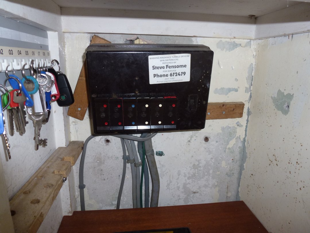

OK guys, some more info. The house was built in 1860, fell into disrepair and converted to living accommodation in about 1960. These electrics are at least 30 years old, because I bought it in 1985. As far as I know, it is a TN-S supply, and single phase. The other two unused fuses on the supply may indicate that was not the case at one time. The isolator switch top left does have a wooden back. It has a 60A fuse. From the back of this comes the flat twin and earth, plus extra earth going to the consumer unit in a cupboard 5m away, here:
Awful, innit? ... and half hanging off the wall! This certainly needs replacing and I would like to sort the cables for it in advance, while I have the floorboards up.
Some clarification: I do know the difference between earthing and bonding, but my terminology lapsed for a moment. I did a lot of electrical work 25 years ago (somewhere else), but requirements have moved on since then. I scanned this forum to find the required cable area for connection of consumer units to the meter. It seemed that the consumer 'tails' need to be 25mm2 - and restricted to maybe 3m in length. However, I know that consumer units can be distributed around buildings with a far greater distance than this. So, I guess 'tail' applies to a connection on the supply board? And I only need 16mm2 from my isolator to the consumer unit? Also, I do not know how much spare cable there is yet, just in case a new consumer unit needs a little extra length.
The tails do not need to be 25mm²; for 60A 10mm² would do so 16mm² is more than adequate.
You will be able to get T+E or armoured if you wish.
You have a switch fuse, which is the requirement for longer than 3m.
Thanks. Your comments are helpful and constructive. So my cable joining the switch fuse is still termed a 'tail', the cable I have at present is probably adequate - but should the earth still be 16mm2 as you said earlier?
Probably. Everyone would fit that nowadays.
Your supply originally is obviously TN-S but as has been said it has likely been altered externally to TN-C-S.
No one will know how effective the original earth sheath will still be.
If it has then the earthing conductor should be the same size as the neutral but then you could get away with 10mm² neutral.
I'd use 16mm² split con unless it's to be flush mounted in a wall then SWA is your only real viable option.
