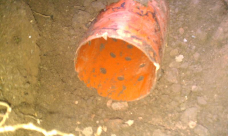

Had drains cctv and jet washed today and after a jet of water sprayed mud everywhere, this orange pipe was discovered exiting one of the inspection chambers (sewer) and leading off about 4 metres into soil and open as shown.
The drain people said to leave it, but considering the amount of mud and stones they had to get out of my drain i'm not too sure I should leave it. It did have a peice of black plastic over it, which i've removed as I was going to cap it off, but then noticed it has holes drilled into it going about a foot or two inside.
Presumably intended as some sort of soakaway, should I just leave it, or cap it off somehow? It runs alongside a block driveway, under a flower bed.
Mike
EDIT: meant to add, it is above the level of the entry into the chamber, so presumably not a soakaway as such but intended to drain the soil into the sewer, so reverse of a soakaway i guess..
Holes look quite uniform in apperance and spacing, so would suspect it is a land drain, although if it doesnt appear to be serving any purpose, cap it off. If you find the area getting boggy, remove the cap at the manhole end and see if it actually drains anything. 110mm caps are available to seal it.

1. Why had the land drainage pipe been originally installed?
2. I would definitely lift the drainage pipe and move it away from the IC.
Then, if the ground still requires draining, i would lay a proper gravel bedding and cover to falls, and drain away to a sump.
3. How does the pipe enter the IC? Do you have a pic?
4. The IC cannot be left with a "hole" in the chamber wall. Debris & soil will enter and create blockages.
5. Regs forbid, under hefty penalties, the draining of land water (water table?) into a public sewer.

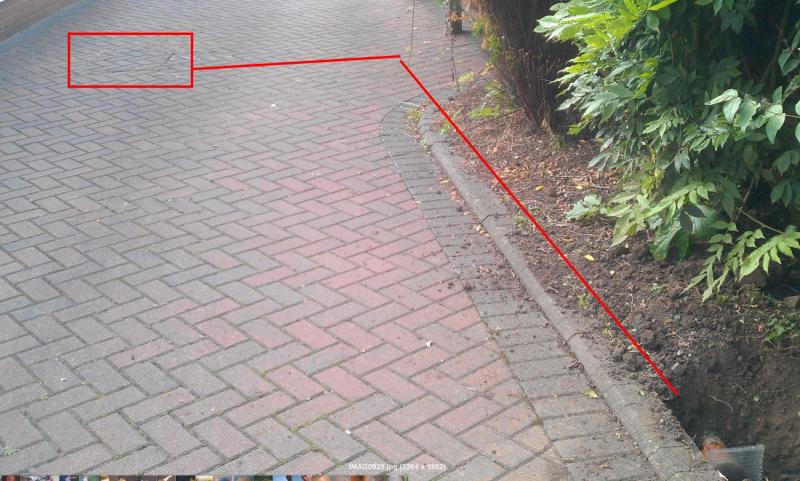

Correct - i dont know why it was put in. I've never noticed that area being boggy (it is overgrown) but perhaps thats because of the landdrain anyway. Opposite side of the drive are 3 gulleys and the drive slops towards those.
The pipe was likely installed, or modified, when the driveway was put down during 2007. The reason I say that is the plastic stuff covering it looked like it had been flattened on top of the outlet, and also as the pipe runs under the drive it presumably was there first.
This pipe, by the way, as I realise it is not obvious from the photo, is only about 6 inches from the surface.
Photo showing location of IC and approx path of pipe.

I suggested displacing the drain on the basis of the initial post where it "ran alongside the driveway", pre the second pic of the route under the drive.
The OP doesn't have to remove it, of course, merely to block the inlet to the IC.

Having looked inside by taking a movie with my cameraphone, the drainage holes don't all line up sort of like it has been drilled. As for purpose I don't know what was laid before the block paving but I guess its possible there was a gulley this side and they just got rid of the drap. Seems a bit shallow mind, but who knows!
I will excavate a bit more with a view to blocking off at top level rather than inside IC. I could do both, just don't fancy doing only IC side as pipe will fill up with soil.
