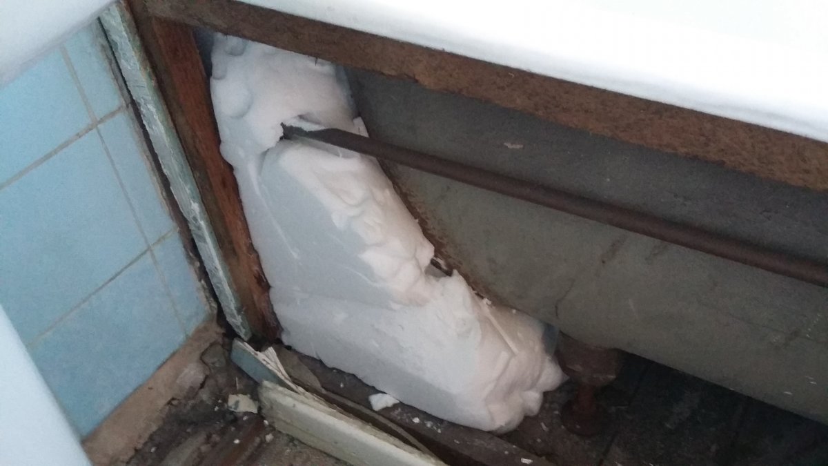

What the hell is this!

Under a bath. Soft to touch.
Looks like some cavity insulation (retrospective injected CWI) has leaked into the void under the bath. No biggie, happens all the time in lofts. I'd get the hole covered up though.
(that's not me!) :eek:
I think you'll find the hole has already been filled up for you... with the foam.
Quite likely where the wall was hacked about to poke a pipe through. It can hold damp though, if you get a leak, so cut it away and have a good look at the floorboards/joists.

Formaldehyde is found in almost anything and often in much higher levels than wall foam.
Sure when it is first mixed it will gas off a bit, but after a few years no more.
What about new carpets, kitchens, curtains, the pillows we all sleep on new kitchens
To name just a few, contain far more Formaldehyde than the wall insulation.
The talk on urea formaldehyde in wall insulation is just BS from the many cowboy firms now cashing in on its removal, which is also a giant con, because what proof do you have that its been removed
The video of a spoof wall the installer shows you, pretending its endoscope footage of your wall
The bags od foam he keeps in his van, to show you he's removed it, when in truth those bags of foam are from somewhere else!
You try to stand and watch to see if anything actually gets removed, but then the installer tells you he isn't allowed to have you watching for health and safety reasons.
Its all a massive con
