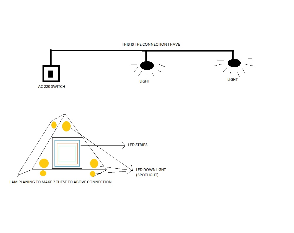

Hi guys i have been searching and goggling for days now. I will appreciate any help. After the search i realized best way to keep bulbs and strips going is to use pwm dimmer and also need power adapter. But after checking quite few websites for wiring diagram am confused. this is my plan and connection i have.

Using PWM for dimming an LED requires special attention. PWM works well to dim incandescent lamps, LEDs are a different matter.

Some LED's have the driver built in and require a constant voltage power supply often called to my mind incorrectly a driver others do not have driver built in and require a constant current power supply correctly called a driver.
You seem to have a mixture.
With a constant voltage power supply to get lamps to dim it has to talk to the built in driver with constant current you simply reduce the current.
With constant voltage lamps go in parallel with constant current they go in series.
It would be less confusing if the definitions were adhered to. A LED is a Light Emitting Diode and NOT a lamp containing an LED and some type of current sourcing driver.
But it happened that marketing people called them LEDs and not Lamps with LED so the consumer gets confused.

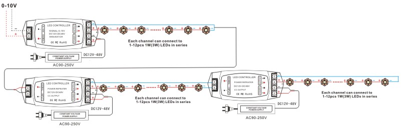

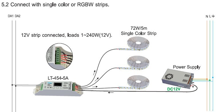

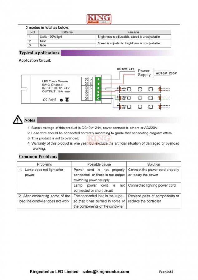

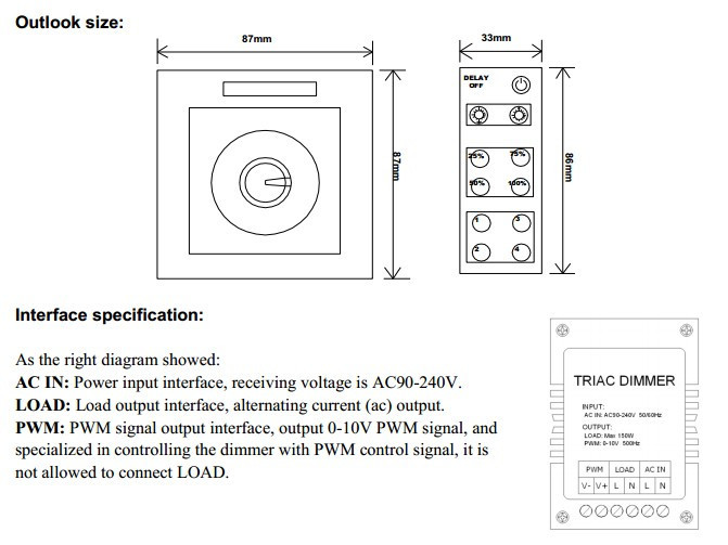

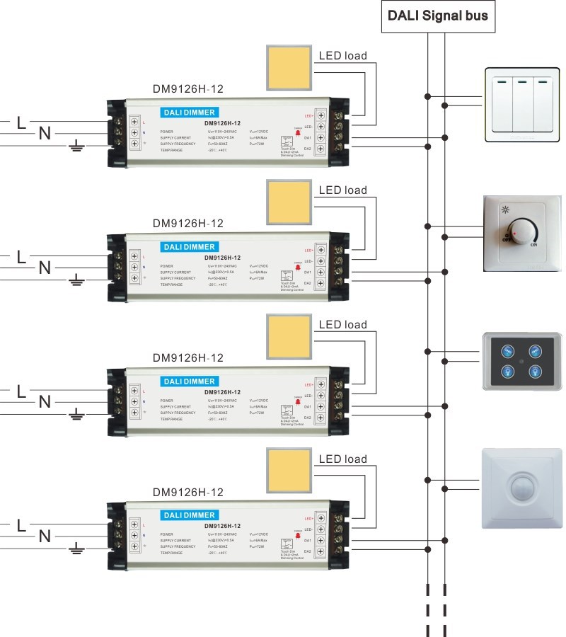

Its neither a spam nor an advertise. One link would have been enough for that purpose. All above links and the diagrams on them shows my confusion. But I appreciate the answers and concerns, guess I will try to save the diagrams and post it so I can explain more. On one of the wall dimmer it shows Input Ac 240V, does that means no power adaptor?

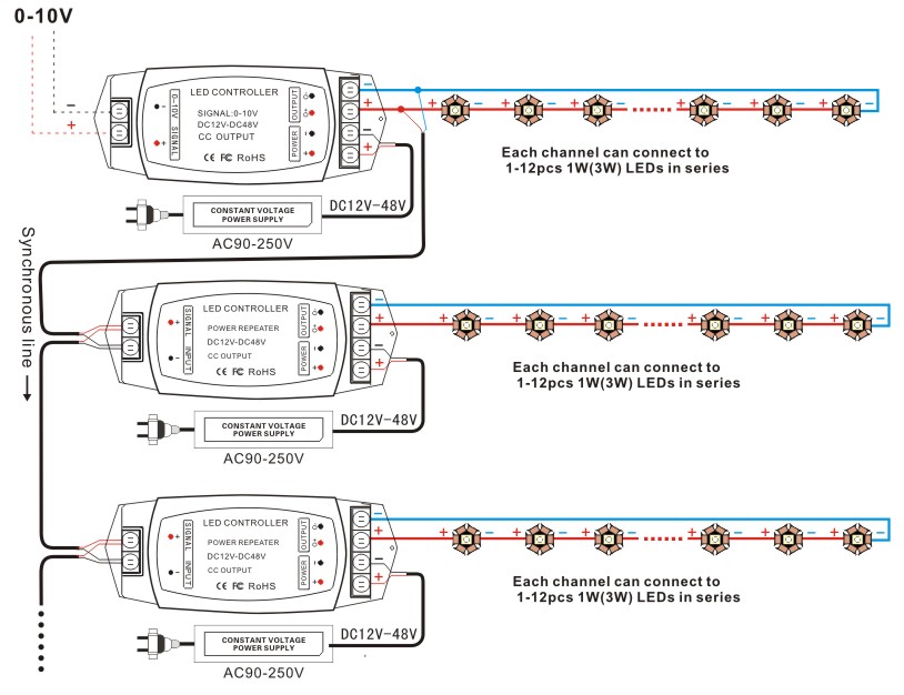

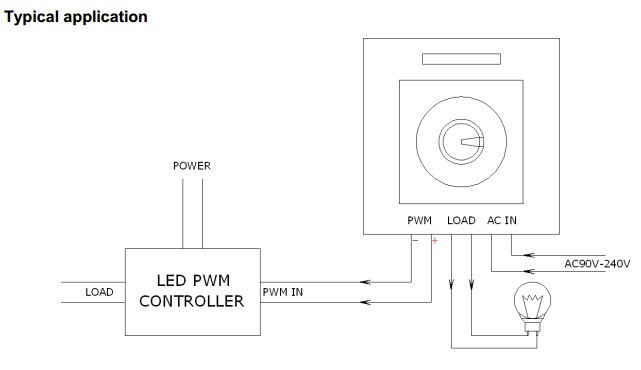

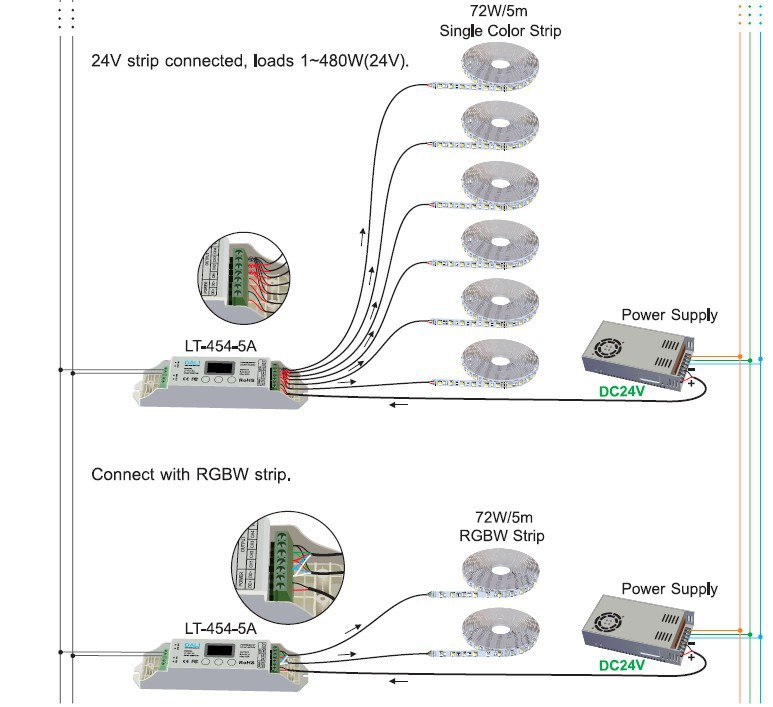

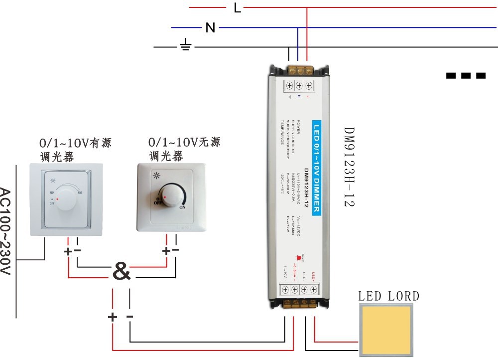

I don't think I've ever even considered buying from alibaba
all that came up on my search. I would love to buy the items here in UK as it will be easy to return if something goes wrong plus the warranty. All I need is help with the wiring diagram as to my plan shown in the first post.
I for one, don't understand what your diagram in the first post is trying to show
I am only trying to show in that diagram that its a simple switch with 2 lights and I want to change them lights to a fixing which will have 6 LED spotlights of 3w I guess and about 2 meters of LED strip EACH, so in total 12 LED spotlights and 4 meters of LED strip. My question is Can this be achieved and how?

Is the location for these lights particularly large, as you have got about 60W of LEDS in each fitting, and 2 of those?

The room is Large. I have not made the fixing yet so open to all suggestions. I am thinking of RGB LED strip and Cool White LED spot lights, but I might try RGB LED spots lights aswel. No dimming control yet but I would like to replace my current on/off switch with the Dimmer Touch panel and wireless remote if I can manage it.
I looked at some of the diagrams you have posted which shows how to use the lights with a dimming switch. But it seems they are not all for the same product and so first job is decide what you want? It would seem designed for use in lecture theatre or some thing similar. Clearly not DIY products.
