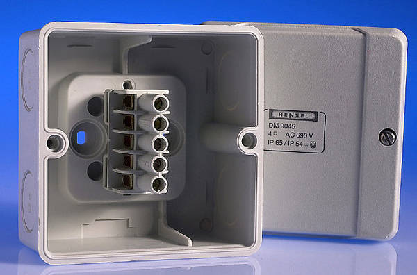

Or are these a better solution? http://www.tlc-direct.co.uk/Products/LB9045.html
They are a better solution, if it is big enough for what you need inside.
I'd drill the metal box to mount the choc block too, but I'm like that.
