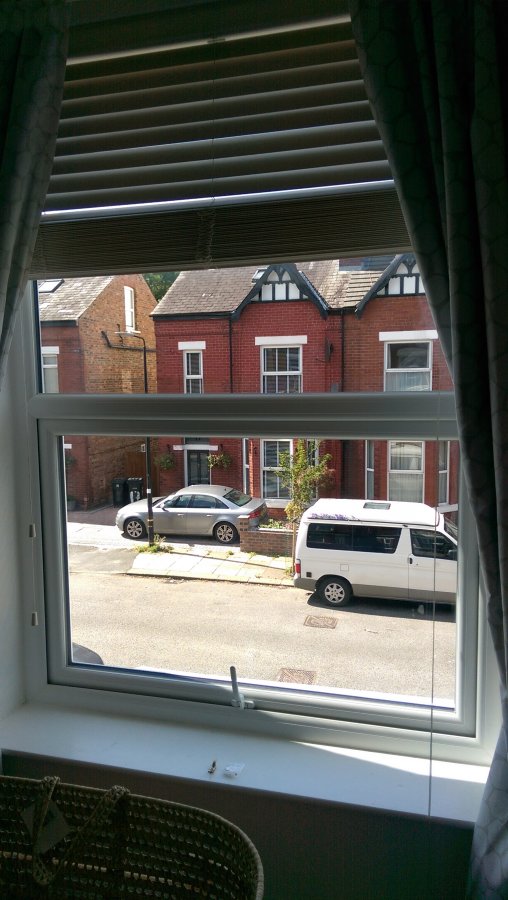

Window won't open - is it because it is too wide?

We've had new windows put in throughout our house but one of them won't open without A LOT of force! The installer is has been putting us off since June and we think he trying to avoid sorting it out and we are worried it is because they have installed a window that is too wide and too heavy.
The opening is 140cm wide by 184cm high and they have given us a single window that is hinged half way down and opens at the bottom.
All our neighbours have windows where the top opens, or 2 windows side by side that bottom open.
Thanks in advance!
1200-1250mm is about the maximum width that most factorys prefer for a max opening width. 900mm tall is fine though.
Can you post a pic and do you know the make of the windows?

900mm tall or 1840mm gaz? Like you I'd like to see a picture though

He said the window was 1840 tall but opens at the bottom so I'm assuming a single/double hung type casement window that has replaced a box sash.
Here is a pic.

Complaints to Fensa probably wont get you anywhere as they only deal with building regulation problems. But as you say if that is the only escape window in the room they might do but I wouldn't hold my breath on it.
Has this window been like it since it was fitted?

It should only take someone an hour max to adjust it. ( I am assuming its just an alignment problem).
Sorry, should have said, we only realised it was like this after a few weeks, but we think it has been so since installation.
It was in a room we didn't use but are now decorating a a nursery! New arrivals (twins!) due end of October so it is really important to us to get it fixed.

A common issue with these large 50/50 split top hung openers is they can settle due to the large and heavy glass unit and they catch along the bottom, could be as simple as that being a new install, I mean what else could go wrong; locking mechanism failure, possible but unlikely, either way they need to pop out and have a look, while they're out just check whether you have restrictor hinges fitted
