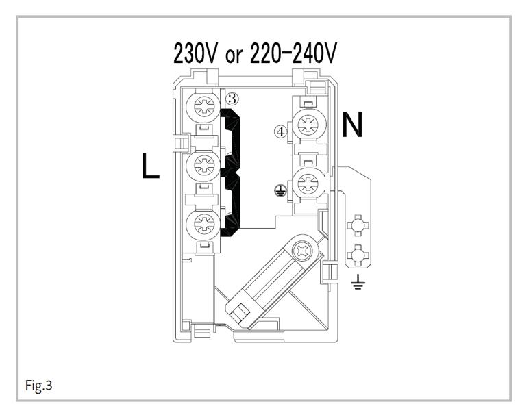

Hi All
I have just bought a new CDA (HCN510) electric induction hob that is designed to run on a standard 13 amp circuit and plug (it can also be set to run off 25 or 32 amps if wired directly to the mains). It arrived with no cable.
The choice of amperage/power is selected using the hob controls when you first switch it on.
I have the correct cable for the 13 amp connection (1.5mm2) but I'm confused by the wiring diagram. The neutral and earth connections are fine, as there is only one of each, but there are three connections on the block for 'Live'.
Does it matter which one I connect to? Or is there a specific one for the 13 amp connection?
I have attached a diagram of the hob connection terminal and the page from the installation manual for reference.
Any advice would be greatly appreciated.

The lives are all linked together so whatever one you connect to doesn't matter.
As long as the instruction don't say remove the link.
Thanks. What threw me is that the diagram shows the horseshoe links in place, but they were actually tucked into a small recess and needed to be connected manually.
Although in UK domestic is normally single phase in France often it is split phase or three phase the links are so it can be configured for French or English system.
So it's all links in for you.
