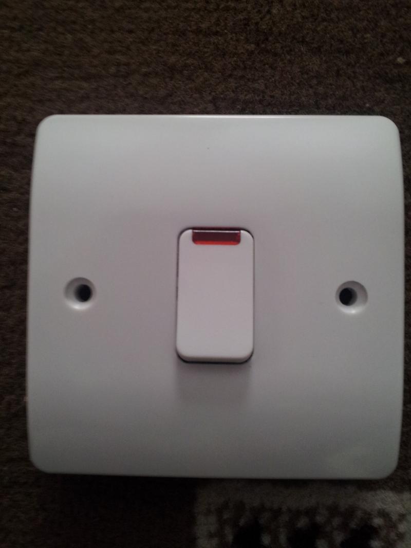

hi Guys,
Can someone please help me with wiring a light switch with a neon light. The existing light switch has one cable coming out of the back box - it is 2 core + earth, I have a live, neutral and earth.
I tried to wire the new light switch with the neon but switching the light on / off works but neon is always off. I want the neon to come on when the light is switched on. See photos of the switch as it may help.
Thanks for your help. VK
You don't have a neutral at the switch position.
You will not be able to make the neon work.
sorry my mistake, when I said it has one wire coming out of back box I meant one cable 2 core + earth. So I have a live, neutral and earth there.
No you don't.
You have a permanent live, a switched live and an earth. No neutral.
The switched live should have a red or brown sleeve over it to indicate it's live, but older installations don't.
If you thought the wires were Live, Neutral and Earth, and you wired it as such, did the switch actually do anything when you wired it?
Seems there might be more to this than first appears.....
If you 'think' you have live, neutral and earth what terminals did you connect each wire to, as you say the light worked but not the neon.
Strictly speaking it's not a light switch, it's a 20A switch intended for things like night storage heaters and imersion heaters. Used as such you would have live and neutral coming in and going out, and the neon would show when the switch was on or off, particularly useful in, say, dark airing cupboards where immersion heaters live. They also get used for loft lights, where the switch is on the landing below; in that case the neon reminds you when the loft light has been left on, but it relies on a live and neutral feed going through the switch.

Thanks all. Sparkwright is right, the neutral I see is actually switched live.
I put the red in LIVE Supply terminal and the black in the LIVE Load terminal and the light can be switched on and off.
I haven't checked in the ceiling rose but the neutrals will be in there, if I had the neurals in the switch I guess this switch would have worked with neon for me. I wanted to replace the existing switch with this neon indicator switch to check if the loft light was left on.
No.
The BLACK you see is the switched live.
So you thought you had live and neutral, you had a switch which told you where to put live and neutral, and you didn't put them there.
