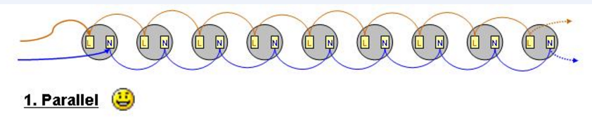

With the first image, why have I got a wire with 2 live and no neutral? How would this fit into a circuit of downlights? My understanding was that each of these would go into a junction box which would form each end of a circuit with my downlights inbetween.

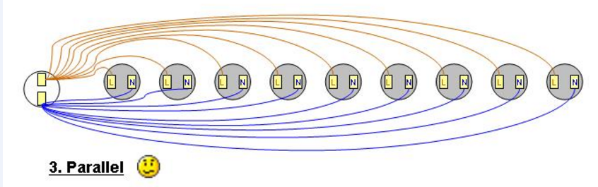

You could use one of these in place of the ceiling rose.
https://www.tlc-direct.co.uk/Products/ASJ501.html
If room you can connect all the lights to the box
or like thisView attachment 99672
Initially I was only aware of the second method as a friend did it like this and advised me to, but after reading up on it yesterday I thought the first method would be more suitable. I don't have access from above and will be plasterboarding over the existing damaged ceiling so I'd like to have my downlight connections in place beforehand then I can pull them through the new ceiling easily and attach the downlights.
