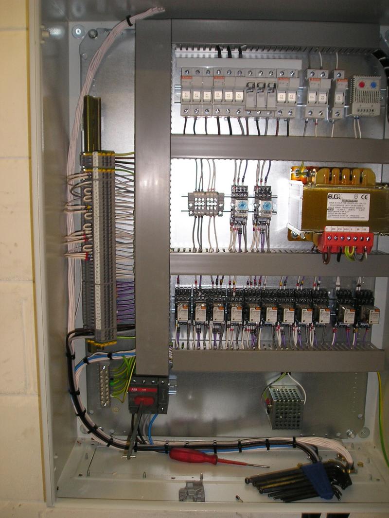

Just to show you how the professionals do it Debzo.
