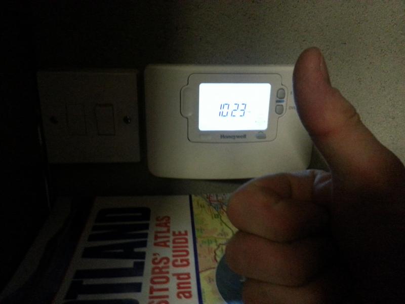

Hope someone can help me on wiring a new electronic timer. I have an old APT push pin timer and I am replacing it with a Honeywell ST9100C Timer.
I've attached images of the old wiring setup and wiring diagram for the Honeywell.

Been a while since I've done one of these switches. From memory, from left to right as photo, it should be; swiched live - live - neutral (blue).
So, wire as -
APT------------------------------------HONEYWELL
sw. L (left)---------------to-------------4
L. (middle)---------------to-------------L
neutral (right)-----------to-------------N
Then link L to 1 with a piece of wire.
Let me know how you get on.

My current wiring has a black wires from both the right L (live) and left N (neutral) connections, do they need connected in the same confiquration i.e.
APT----------------------------------------------HONEYWELL
Black / Brown (L) (left)---------------to------------ 4
Red (L) (middle)----------------------to------------- L
Blue(N) Blue (N) Black (right)--------to------------ N
Yes, that's right. All wires in left connector on APT to 4 on Honeywell and so on.
Technically, the black wire in the left (switched live) terminal on the APT should have a red sleeve or tape over the black insulation to mark it out as a conductor.
The black and blues in the right connection are fine as they are all old and new colours for neutral.
Thought I'd give it a go before I hit the sack. Installed easy enough, most difficult part was drilling the extra hole for the bigger back plate.
Saying that your guidance was invaluable, so a big thumbs up and thanks again.
