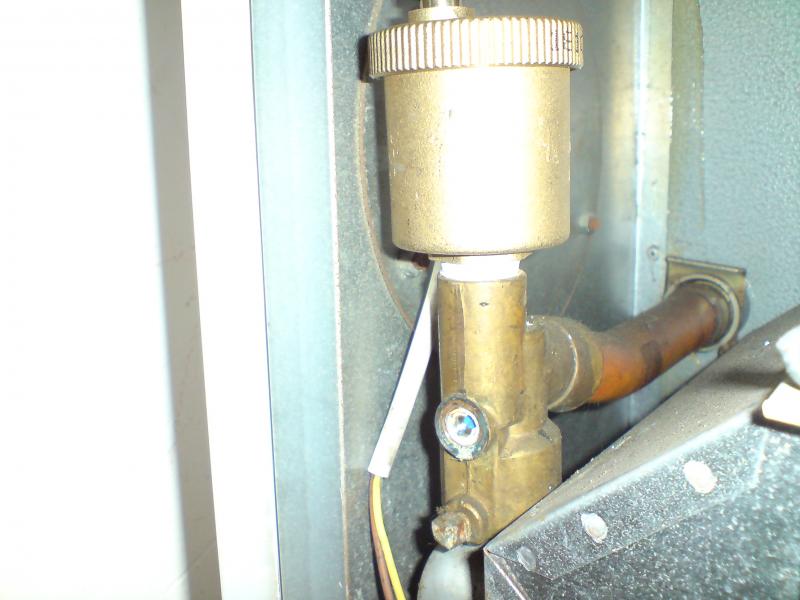

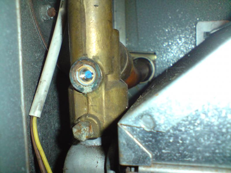

If the thermistor has been snapped then drilling and using a stud extractor would be the usual solution. To get it going a clip on stat might be one way.
Can anyone post a picture of this pipe with the snapped off thermistor?
Tony

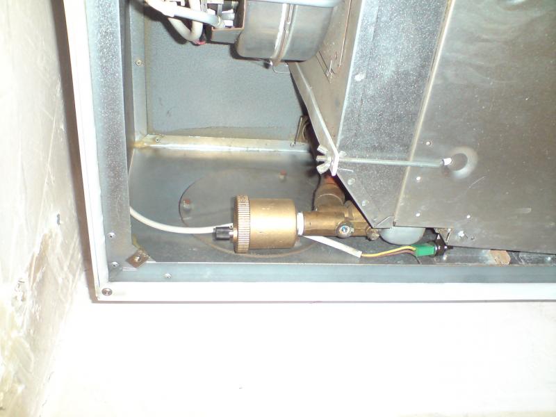

Whats the green plug connected to?
Tell us or take a specific photo of it.
With a sensor connected to it the boiler should run but just not control the temperature and so go to overheat.
Tony
The green plug that's hanging down is connected to a thermistor, the gas man plugged it in and said I would get hot water only but it would overheat and i would have to keep pressing the reset button, he said the central heating would not work, I have tried it but it locks out straightaway. So we have had some hot water, and the amber standby light stays on for about 6 hours then goes off and I then press the reset button on the top of the boiler and we get some hot water again. Also the boiler makes a very different noise when i try and put the central heating on to the noise it makes when we turn the hot tap on.
From everything that has been said then I basically need someone to drill out the broken thermister and put a new one in and I'm good to go. The thermister should be here tommorow and I will ring an independent gas safe man to do the job. Thanks for everyones help with this, hopefully I have just saved 2000 pounds which I don't have at the minute. I will be on to homeserve tommorow inn the hope they will pay for the work. Once again thanks.
My girlfriends dad came round yesterday, wedged a screwdriver into the broken thermister and screwed it out , new thermister in bolier fixed, So after 3 weeks without water and heat, it turned out it could be fixed in 10 minutes. Homeserve are now going to get it both barrels, thanks for everyones help with my problem.
