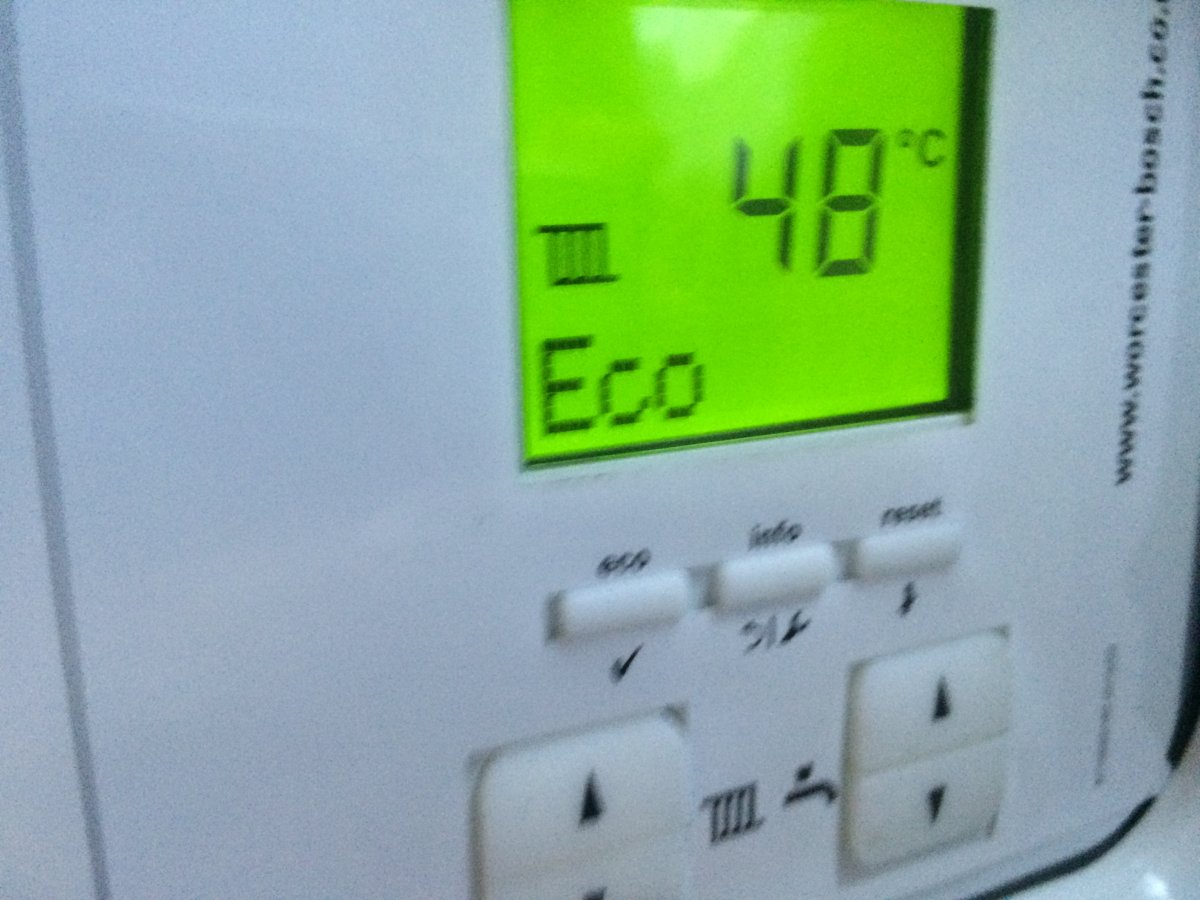

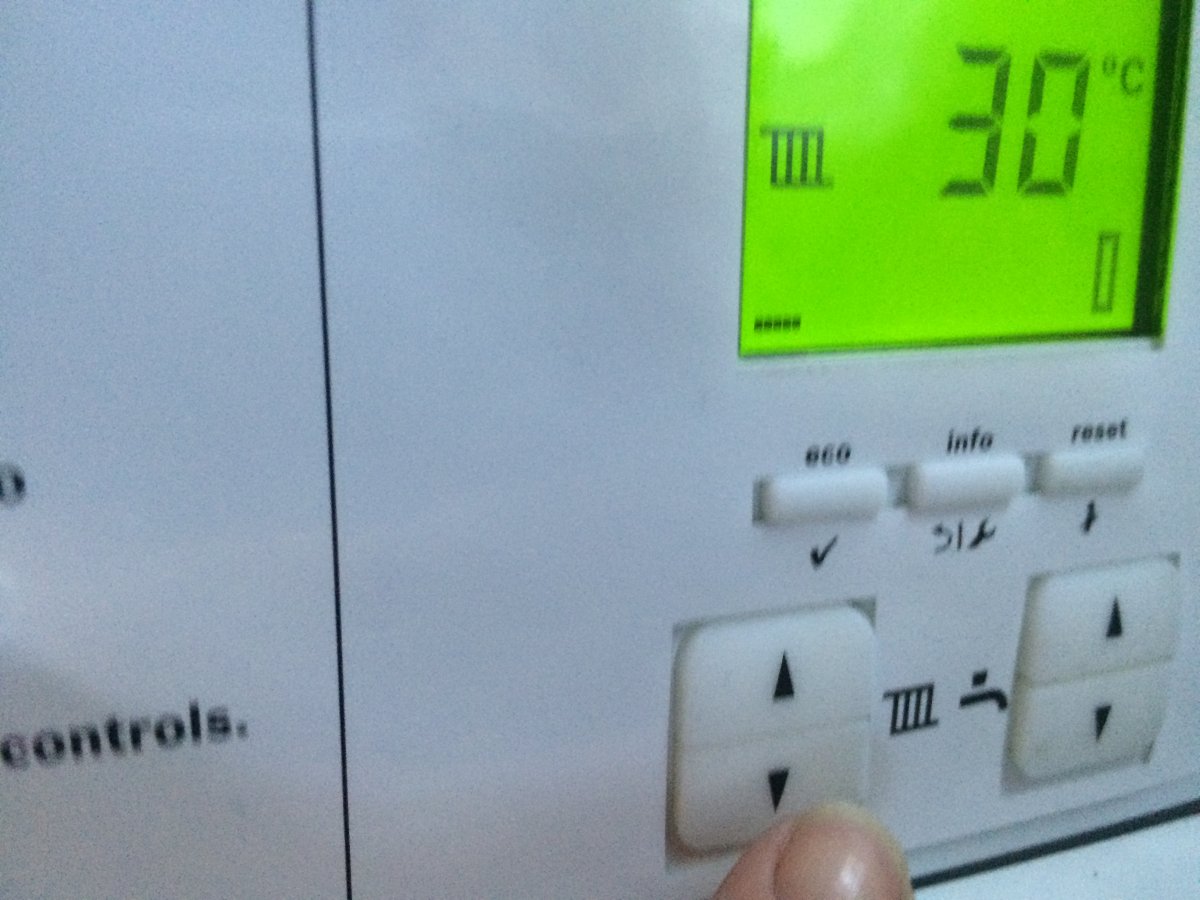

Can anyone help I've just had a new green star i boiler installed the gas engineer who fitted it for me ( my ex) is now not speaking to me ( won't bore you with domestics ) so I've not been shown how to se the controls - I don't have the wall thermostat just the boiler in a cupboard. I can't work out how to turn off the central heating - it goes down to the number 30 on the control ( on the boiler itself) but will not go down any more - the manual is not helping me. I've turned off all radiators & just left on towel rail. But in London 25c I'd really like to turn it off completely - I'm terrified of a mega bill in a few months. Please help - thanks the manual tells me to keep pressing down arrow on boiler controls - the ones for he heater - I've tried everything & will not go below 30 - I'm sure it's something simple but just can't work it out - thanks

Can you post a pic of the front of your boiler with the controls on show? Is there any kind of programmer elsewhere? You need to have a programmer and thermostat to comply with Building Regulations.

Ok will do tommorow no don't have separate thermostat or controller just what is on the boiler thanks

Sounds like he wired it up incorrectly, as there is an external demand for heat indicated on the display.

The symbol on the display that looks a bit like a radiator means that there's a call for the radiators to heat up - if there was no demand, that symbol would disappear. If you really don't have any other controls, then there's no way of turning your heating off I'm afraid, it's going to be permanently on until you get someone to wire some proper controls in. Can you take a slightly more zoomed-out pic of the front of the boiler so we can see all of the bottom half of it?
The button you're pressing will never go below 30 - that controls the temperature of the water in the radiators, not the temperature of the room. It'd normally be set to around 65
Thanks muggers, after re reading the manual last night it clicked the 30 is not the temp of radiators output if they were on its the internal temp of the boiler( correct me if I'm still being thick) the radiator symbol only comes on as it is in the photo because I pressed the control arrows for the radiators to get the display to light up. I'll try & get another pic. And you are right a thermostat or maybe wave control system would make life much easier. I have noticed that when its been very warm like today the towel rail which I left on is not even warm so maybe it is working as it should. I seriously don't think it has been wired incorrectly as suggested by a post - y my ex has been plumber & Gas engineer for over 40 years is gas safe certified etc etc etc and was speaking to me when he fitted it ( ha ha ) Thanks for your help mch appreciated - I get annoyed at myself for not being able to work this stuff out!
He's left the permanent link in place, as there is no programmer or thermostat. Get someone in to fit a programmable room thermostat.
Is there not a frost protection setting where clicking it turns the heat off unless the temp goes under a certain value? Failing that, till it's fixed, what about pressing that down button your finger's on till it shows 0?
