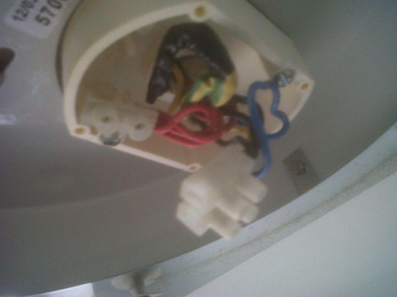

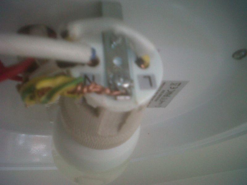

My bathroom light stopped working, I have replaced the bulb with no improvement. The old unit is no longer in supply so I will have to buy a new light fitting. I have put in light fittings before but am somewhat confused by the wiring coming out the ceiling :( I have looked at the Wiki but am still confused.
So there are three cables:
Cable 1 has a 1 black, 1 yellow-green and 1 red wire coming out.
Cable 2 has 1 black, 1 yellow-green, 1 red and 1 blue wire coming out
Cable 3 has 2 reds and 1 black coming out.
There is a single yellow wire coming out of the ceiling hole but which is not coming out of any cable.
All four reds are bonded together in a seperate connector.
The 2 yellow-green wires are bonded together with electrical tape.
Black from Cable 1 is bonded with yellow one half of another connector
Black from Cable 2 and Black from Cable 3 are with blue in other half of same connector. This connector was wired to the old light fitting although I forgot to note which way round the neutral and live wire from the old light fitting went in.
I have not bought the new light fitting yet but assume it will have seperate earth, neutral and live connectors. I assume that I put the green-yellow in the earth connectors but am unclear about the neutral and live configuration?
I am attaching photos. Apologies for quality. Hope you can help :)

And the reason you know that the fitting is faulty, and not the switch, or any of the wiring is.....?

Have you used your multimeter yet to identify the switch drop, permanent live(s) etc?

#2 and #3 are very odd combinations - you're sure they aren't sleeved those colours? #3 is of particular concern - could be twin & earth with the earth used for something else.

Probably permanent lives.
Loop in, loop out, switch, and... Do you have a fan worked by the light switch?

Naughty - should be a proper connector. And does the light not need an earth?

Check to see if that's switched live.

Check to see if that's neutral loop in, loop out and... Do you have a fan worked by the light switch?

They should be earths. They probably are. But wires have no understanding of what they should be used for, and anybody can put any colour sleeving on anything.
Given that there is a possibility ("Cable 3 has 2 reds and 1 black coming out") that a numpty has been there and a core meant to be used only as an earth is being used for something else (and sleeving the bare core of twin & earth to use it for something else is not OK), I can't say with certainty that your G/Y ones are earths and could safely be connected to the earth terminal of a light.
Short term solution would be to buy a new light which doesn't need an earth, but longer term you should get an electrician in to check if everything is kosher.

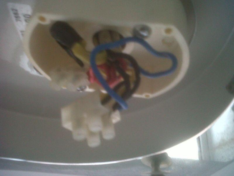

I had another look at the wiring because of what you wrote. I made a mistake :) All three cables have one red, one black and one yellow/green. There is a blue, a yellow and a red sleeved wire that are not cabled and go up through the hole above the ceiling.
Two of the yellow green wires are then sleeved together and bonded with the third in a block.
Given the above, does it make the wiring more explicable and less dangerous?
Can I now I buy a light fitting with an earth - it will be hard to know if it has one until I open the package..
Many thanks again and sorry for misinforming you the first time round!
So you've got 4 cables?
3 red/black twin & earth, and 1 red/blue/yellow 3-core & earth (which appears to have had it's earth core cut back)?

I have 3 cables and three wires which are not in a cable. The three wires without a cable are a red, a blue and a yellow. They are seperate wires. I thought the yellow was another earth but from what you say I understand that normally there would also be another earth wire which has been cut back. Anyway things seem to be falling into place :)
Or it's 3C+E with the sheath cut back a long way.
However if I can't get hold of a light that doesn't need an earth, is it OK to use one that does and put the three yellow/green wires in the earth socket of the new light fitting?
Should be, if all is as it should be.

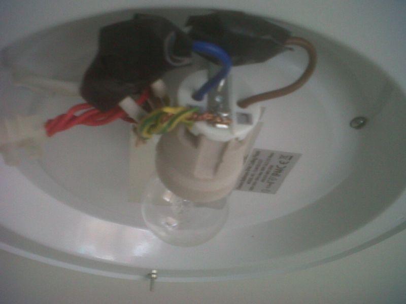

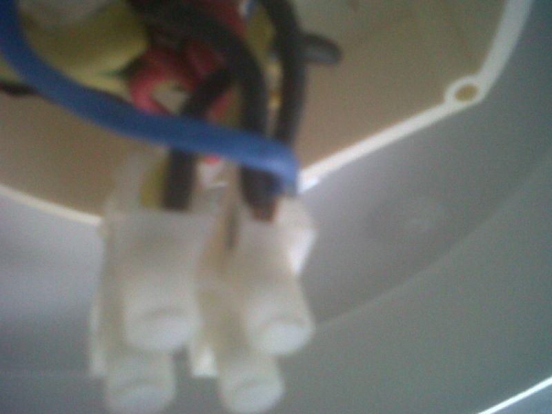

I wired the fitting in on Monday. The main problem was getting the three 'neutral' and four 'earth' to fit in sockets made for one. The other problem was that the wires were not long enough. In the end I got them in but there was exposed copper as can be seen from
I went back the next day and wired in two junction blocks for neutral and live and covered them with insulating tape:
However the earth wires are still exposed down to the copper. Is that dangerous?
It's a mess, and the connections are probably dodgy - the earths are certainly unacceptable.
Take it down and do it again - fix a 4-way strip of choc-block to the body of the light, as far away from the lamp as possible, take all the circuit cables to that and then just 3 connections to the light.
Did it come with any heat-resistant sleeving?
OK - how would you fix the choc blocks to the light fitting - with insulation tape or something else like glue? I assume I use the heat resistant sleeving on the single 'extension' wires going into the light fitting (I will have to buy some more of the stuff as it got wasted in my attempt to fit all the wires into the light sockets)
