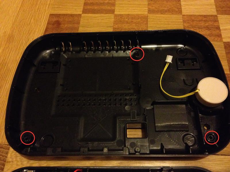

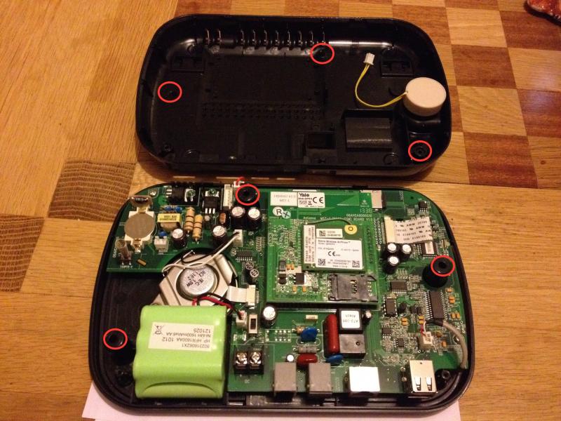

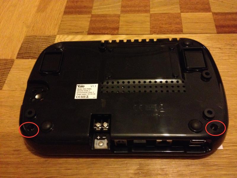

Here are a few photos of it opened up..
The wall mounting holes on the baseplate:
The case screws on the baseplate:
You'd either expect the electronics to be on the baseplate or the case screws to be through the front if you could wall mount the thing...
Interestingly, there are holes that match the wall-mountings in the front panel. (see first photo) but there's no obvious way to get at them.
