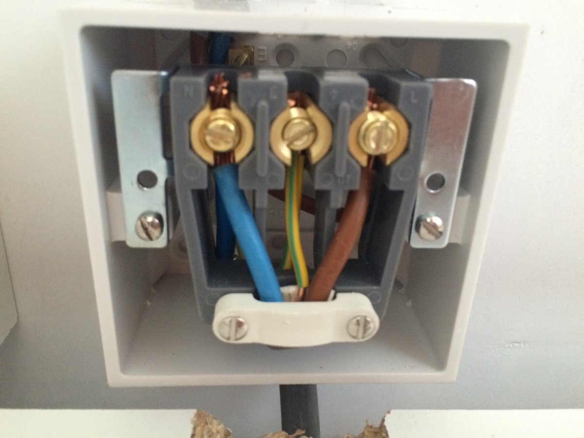

I'm not a qualified electrician bit I have bit the bullet and tried to install my Zanussi hob.
I purchased a 45a cooker outlet plate and removed the cable from the old cooker into the outlet plate. The cable is 6mm t&e which comes from the cooker switch as installed when I had a re-wire.
I then installed a 6mm t&e cable from the outlet plate to the hob. All live, nuetral and earth connections are fine tight and secure.

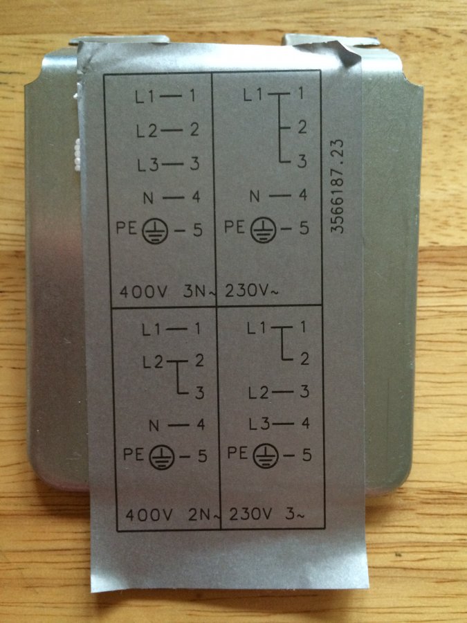

Many hobs like this have several options for their supply voltage/number of phases, etc.
My first thought is that the OP should make absolutely certain that any power straps are properly in place.
Many hobs like this have several options for their supply voltage/number of phases, etc. My first thought is that the OP should make absolutely certain that any power straps are properly in place.
Good point. I wonder if the OP could provide us with a photo of where the connections are made to the hob?
Kind Regards, John

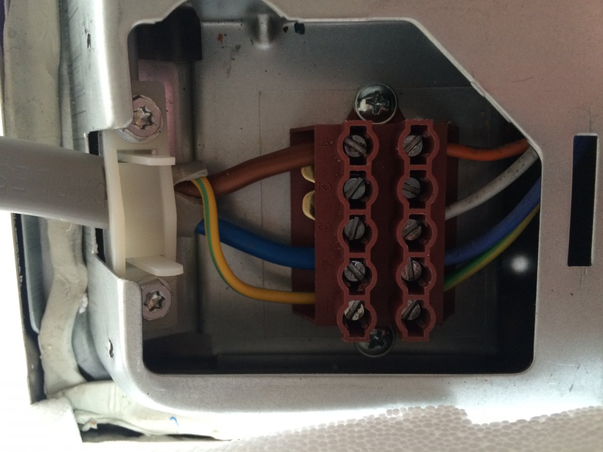

I've included a picture of the cover plate showing the various wiring options. These are post testing so there is no melting to the cable after what I originally wrote. As can be seen, the live terminals in the hob are connected by the metal u shape objects.
So my over riding question is, using the 45a outlet plate, 6mm t&e plate to hob and the wiring I have used at the hob........have I wired this correctly?
