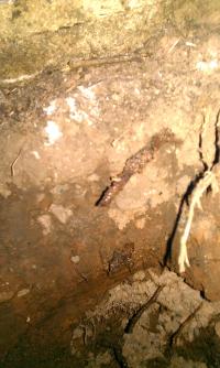

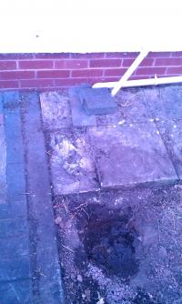

Sorry tim00, I realise I am jumping around a bit but I think I might be getting somewhere.
I will get a scan done for you when I get time.
However, the hole I dug under the bush is showing water appearing from the side wall of the hole closest to the gully.
I have attached some pics.
You can see the gully in second pic. This is a clay gully, all others are plastic and were renewed when the building was extended. This one seemingly original. This is the one that drains oddly, a trickle then a second later flows from toilet soil into inspection chamber/drain.
The hole smells a bit too, and seems to be attracting more insect attention than the first hole I dug, which incidentally is dry and only about 1m away from the bush hole (wet one).
Since digging this hole, both damp areas significantly improved. Could be coincidence of course. I want to take scientific approach, not counting chickens etc just yet.
This gully is approx 2.5m from the internal wall damp spot btw, almost directly outside the building in direct line along an internal brick wall.
I will post a plan when I get a sec.
