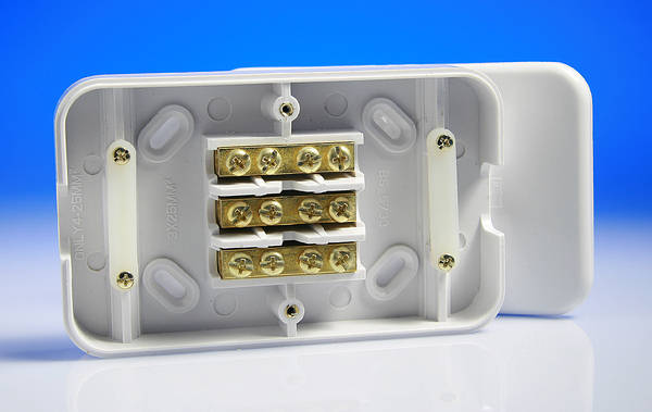

Getting a bit confused here. The wires in question are not long enough to take to any sort of connector block on the din rail, so was intending to have loose in-line joints using connector strip to extend these wires by 2 or 3 inches to reach the consumer unit neutral strip. FWL_Engineer suggested crip terminals, but I assume we are talking about butt crimp connectors to make an end-to- end joint on each wire. As a matter of interest, why are the screw connections of a connector strip unacceptable?
I fail to see why connector strip is not acceptable to extend cores, there are JB's on the market using connector strip and virtually every accessory uses screw terminals, I have seen quite few crimp joints on solid cores fail and will never use them on solid core cable. It is not ideal to have floating joints though, and they should be secured to the base of the enclosure, difficult to do that with crimps.

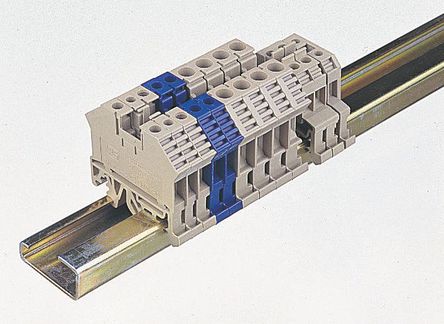

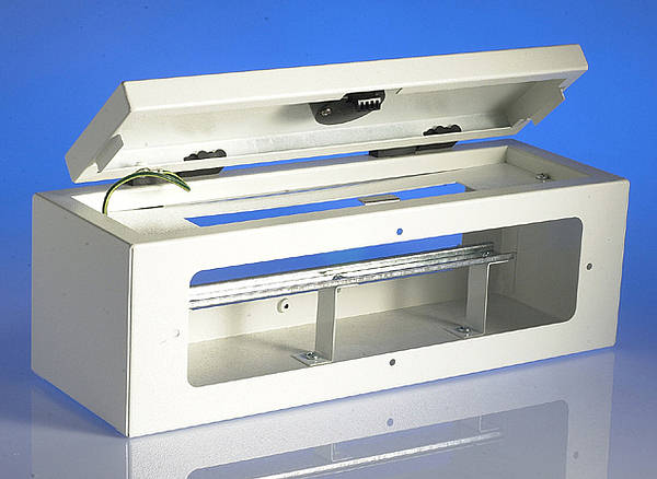

What about putting something like this before the CU:
Position it so that the existing cables reach it comfortably, use DIN mounted terminal blocks:
and new lengths of cables through to the CU.
no bas
din rail terminals are not shaped properly to be fitted into CU style din rail enclosures (which expect a device with a large protrusion in justthe right place to go through the panel
also that box is intended to be bolted to a 3 phase board and for the end cover plate of the 3 phase board to be moved onto it its not really suitable for any other fitment

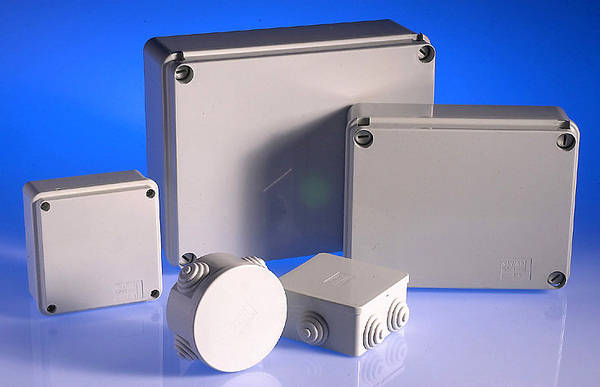

What about mounting the CU in such a position that whichever group of cables is the lesser (ie those going up or those going down) can reach, and the others are extended via accessible jb's??

Well - on closer examination of the picture......
You're quite right - it'd be useless. :oops: :oops: :oops: :oops:
So buy a length of DIN rail and put it in the adaptable box of your choice
Or maybe a row of these screwed to the wall?
They're rated at 60A, with 2 screws per conductor they should achieve a good contact, and with all but the largest cables you could probably get each one to run all the way through the terminal thus having 4 screws bearing down, they are enclosed, they have grips to lessen the chance of mechanical stresses on the connections, and they are accessible for inspection.
There is no logical reason for them to be unacceptable, but we all know about logic and wiring regs, don't we? ;)
Still like to query Jim's connector versus crimp, especially on fracture-prone solid conductors.
