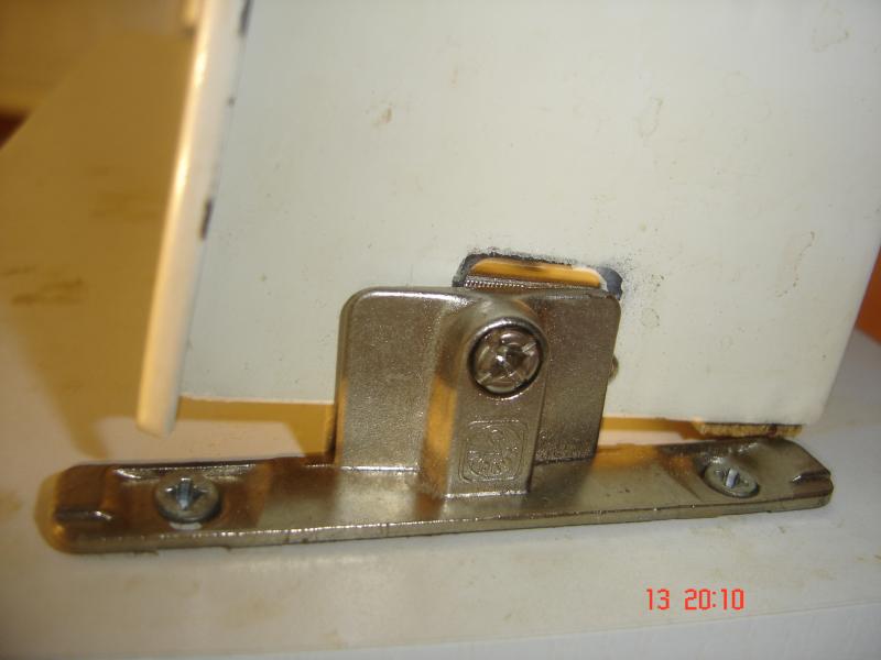

The drawer fronts on a couple of my kitchen drawers have come off due to the fixing that attaches the metal drawer side to the wooden drawer front breaking.
The fixings have the word 'INDAUX' on them.
Does anyone know where I can get these as I don't seem to be able to find them or an alternative solution would be welcome.
Thanking you in advance.
is that on its side?
it looks like there is a hole and that it has "slipped" within the peramtiers of the hole, if so can you not loosen it push the front back and tighten it?
Yes it is on it's side.
That is actually a picture of a complete one. The ones that have broken have gone across the strip that sticks out at each end so it can be attached to the draw.
I basically need to know where I can get similar replacements
I have exactly the same problem ..the brackets are cheap and nasty...Did you find any supplier???
I've decided to use Araldite rapid to glue the centre bit back on...it may work on a occasionally use drawer...swapped good ones for frequent used drawers

I found the supplier by google search on INDAUX (at Maidhead) but there was no reply on the phone (answer machine)...I found using araldite a good soln. so didn't bother to try them again.
Mine broke on the flat between the screws, so Aradilited the plate instead of screwing it on..Seems OK
You can reinforce the existing will 90 degree angle brackets screwed to the base of draw and draw front, will put less strain on weak fittings.
I have just phoned 01384638700 and ordered 4 fixings total cost delivered £12.50p thanks for the above number.
