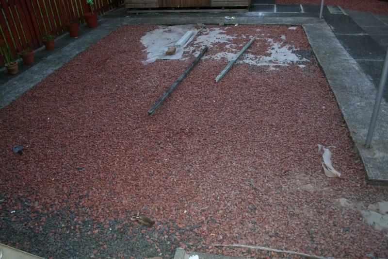

Hi all,
I've had enough with the chippy stones and I'm going to put down some play bark and a small play area.
Just now it's just plastic sheet and red chippy stones.
What I won't to know is should I remove the plastic sheet stuff and replace with weed block or just put weed block on top of the plastic sheet.
Will drainage be ok if there is a hard rain?
Rezarf
take up the plastic and put a decent fabric down. it will allow the water to drain away
You will also have to consider removing some depth of soil underneath, too, as your bark will otherwise be sitting too high to prevent it being scuffed onto the concrete. Bark is only of use in a play area when there is plenty of depth. A good 4 - 6" is a good target to aim for.

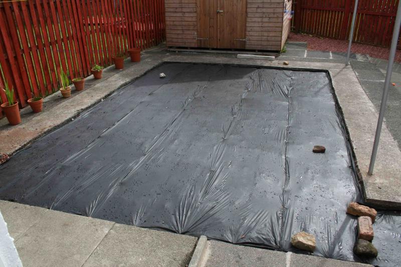

well removed all the stones and plastic with some help from a friend.
Anyway I have put down the weed control fabric
Will one layer be enough? As I still have enough left to put a second layer going horizontal would just need to get some more ground pegs.
Just need to get the play bark ordered.
Rezarf
One layer is fine. By how much did you overlap the lengths? Ideally you want about 4-6".
