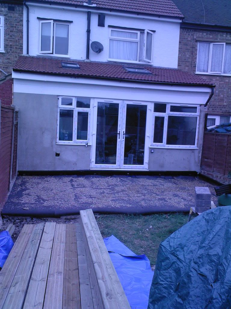

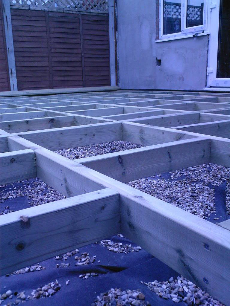

Patio levelled, membrane put down, pea shingle on top and drain system built and put in place.....

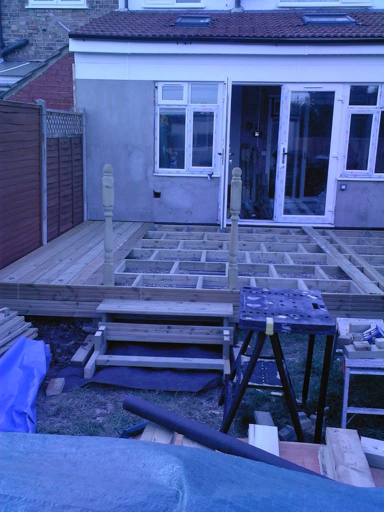

Concrete blocks set out and cemented through "X splits" in the membrane, all levelled. Frame them layed on top and bolted into the blocks...
Posts levelled and bolted to frame. Stair Frame built and decking beginning to go down....

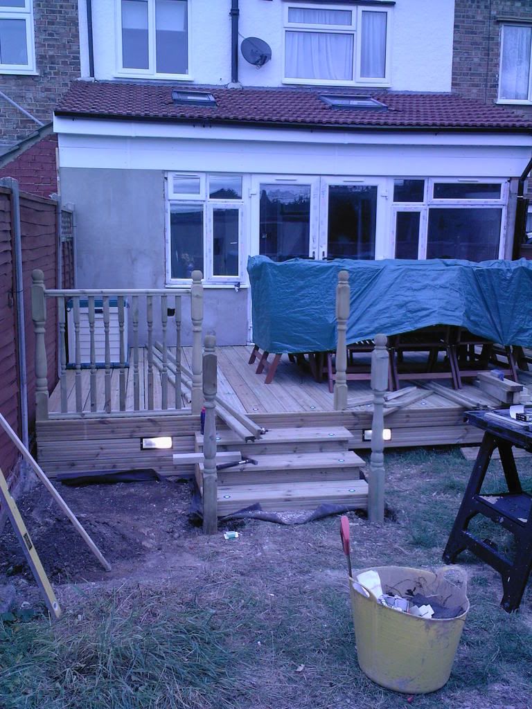

Ground level post holes dug out, posts levelled and concreted in. Small Handrail build and secured in place....
Just got to put the finishing touches in now and finish off the hand rails along the front and down the stairs. I hope to get it all done this bank holiday weekend. I pray for the rain to hold off.

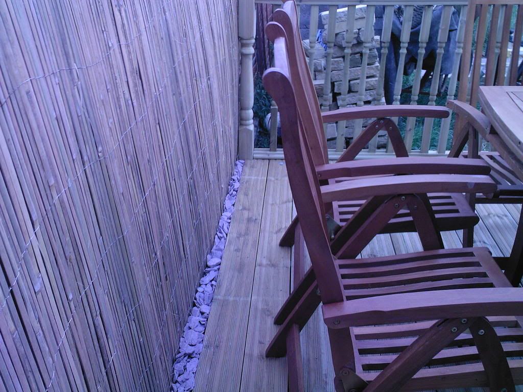

Anyone know what I can use to block the gap off between the decking and the fence to the left in the last picture ?. I'm going to have a BBQ there but don't slipping down the narrow gap.
what a good hubby you are :D as for the gap between the fench/desking I planted lots of climbers in the soil in the gap between the fence/decking then screwed trelessing to the fence and the clemates grew up between the gap & covered the fence.
oh yer, decking looking good.
That, my friend, is a fine looking job. I have seen far far worse built by so called pros. The lights look very good. Never seen such neat Noggins. :cool: :cool:
What's yer fall from the house to the garden? How about using some square beading to edge against the fence. This would stop anything falling into the gap.

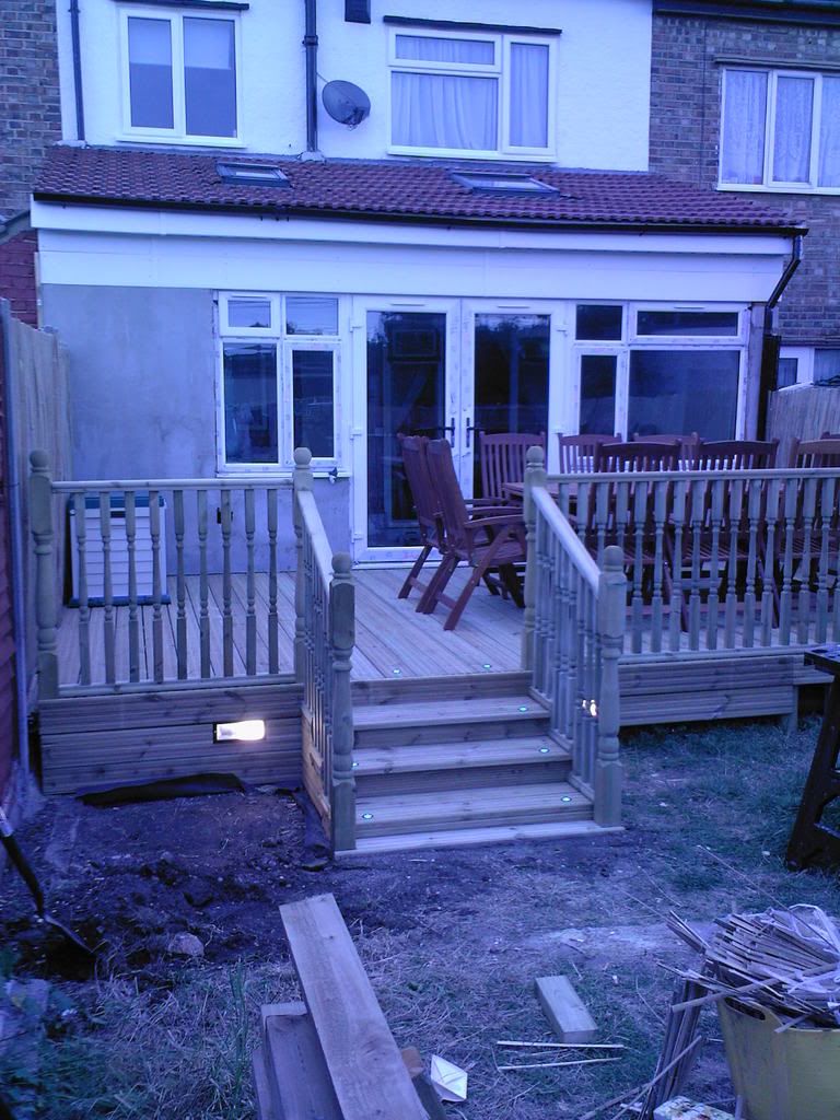

A litte more done today.

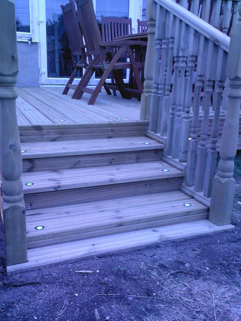

Stairs now finished, Final step put in place and handrail made up. I did try the lower rail running parallel with the top to start with but I just really didn't like it like that.
Finished all the handrails now as well. Also fitted some babmoo screening on the fence in the decking area.

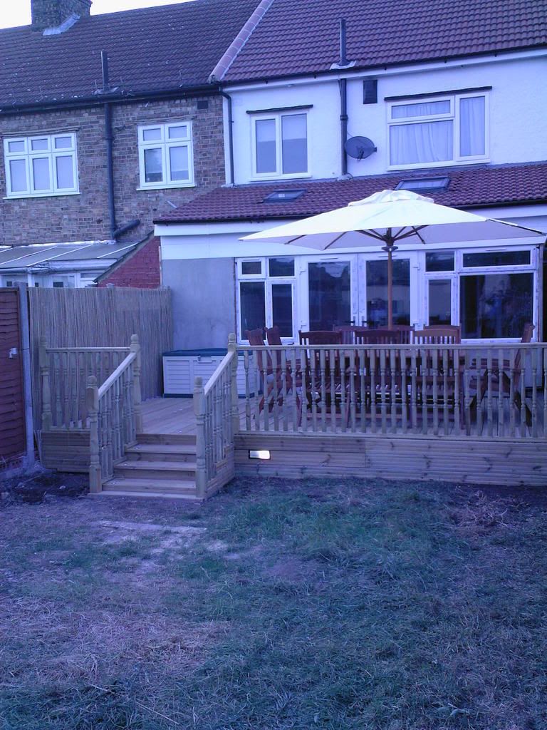

Finally Finished.

Just an observation, the run of balustrading to the left (looking from the garden) looks quite long between newel posts. How long is it and is it solid?

Was at a loose end as what to use but in the end I used the excess cuts from the bamboo screen to fill the gap down the sides, left about 3" on top and filled with plum coloured slate chips.
To the left looking from the garden is 1.1m to the right of the stairs it's 3.5 meters. I was worried that I may need another post in there to give it extra strength as having a youngster, she's going to be climbing all over it in a few years I'm sure. First I thought I'd see how secure I could make it without another post. Each of the spindels is 8mm dowel rods in the top (glued with weather proof wood glue), and screwed from the bottom. The balustading was then put in place and screwed to the joist (through the decking) between every 5 spindels, the infil then covered all screws. It was also bolted each end (top and bottom) using two recessed screws and and holes filled with a plug cutter bit (matches up very well and is hardly visable). This was a bit of a pain doing it this way as I had to temporarily remove the fence panels either side to actually get a drill in there.
Does it come as a kit or did you make it all up as to speak?
You can buy kits from somewhere like screwfix where you have to make it all up but it kinda just slots into place (or so I'm told), however I designed it before and worked out that I could save £400 buying the timber from a timber yard. Knowing that the lengths of Deck & 4x2 were either 2.4m, 3.6m or 4.8m. I designed it so that it would come out from the house by 3.6m, that way I didn't have to cut any of the deck board (except round the posts) on the deck itself.
I bought the following:
45 x lengths of Pre treated Deck planks (3.6m x 150cm)
45 x lengths of pretreated 4"x2" joists (3.6m)
60 x Cordinal spindels
6 x Cordinal Newl Posts
3 x lengths of Hand/Base rail (4.5m)
5 x lengths of infil wood (2m)
Hope this answers all the questions, sorry if I missed any out.
