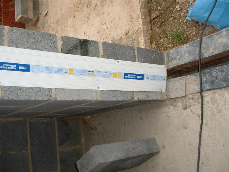

Hi all just about to fit plastic cavity closers into window and door openings do if fit them to the cavity at floor level were the doors will go.
Cheers Laurie.
no. the flooring material (concrete, screed) should go right up the the sill.
Hi this is a new build extension i am talking about the out side doors ie the front door plus 2 French doors, the gap between the outside wall and the inner wall.

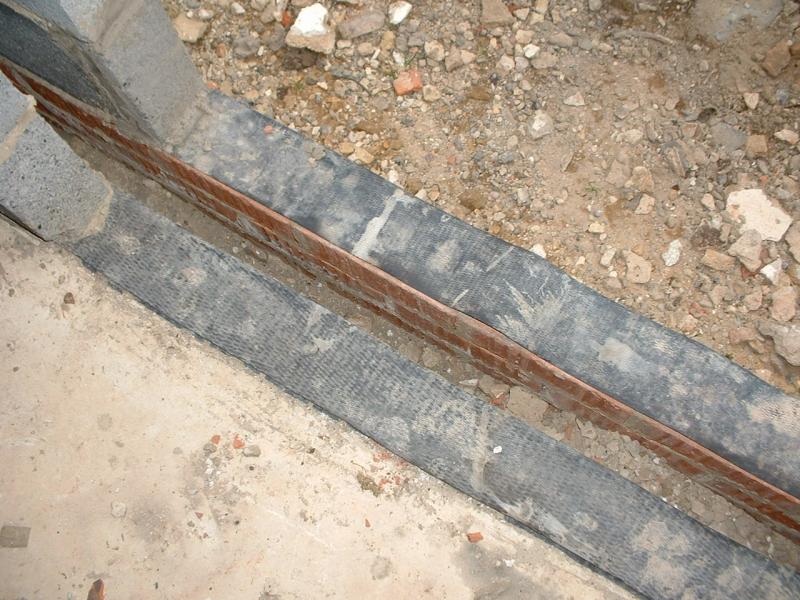

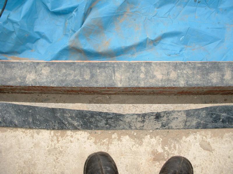

cut the dpc through the centre and fold back.
remove the top course of bricks from the inside skin or hack off 75mm of block, if it is blockwork.
lay the dpc back down.
lay some dpm into the trough.
fill with screed right up to the back of the door sill.
Hi thanks for that i will cut/ hack the blocks and fill, job for this week end.
