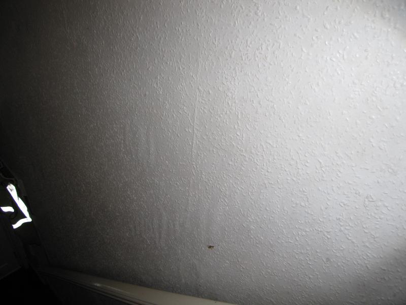

Hi,
Thanks for the advice. I've attached an image of both the inside and outside of the wall in question. You can see outside that there are fine black lines. I don't know if these are just that the wall needs a good clean/is old or weather the brickwork is actually damaged?
Cheers, AGAIN!
OUTSIDE:
INSIDE (not the wrinkled wall paper):
It looks like your house is built with a semi enginering brick which is very hard and certainly wont allow water penetration. Unless you can actually see holes in the jointing I would say it's just due to cold damp weather and shouldn't cause to much damage.
Come to think about it, since the damp is so low down you might need to re-point just the damp course. Thats the only direct route through the wall. Do you know if the floor boards are getting damp too.
Thanks so much for your help.
One final question. As you can (probably see) from the photo, the mortar isn't too bad. Do you think I should just re-point anyway or do you think it's just the weather? I don't mind re-pointing but I'm not whether that is the best action as I'm not sure if that is the problem to start with....
THANKS in advance!!!
I don't think the whole wall needs re-jointing by any means, maybe just the damp course.
The problem may be condensation. Even with your heating on condensation can occur if the temperature of the wall falls below the dew point. For example if the room temperature is 21 and the relative humidity is 80% then if the surface temperature of the wall is 17 or less condensation will occur.
The wall is probably 9 inch brickwork. It looks in good condition, but if there are slight cracks in the bed joints water running down the wall can enter. This problem is actually worse with engineering bricks as a softer brick will absorb a lot of the rainfall and then allow it to evaporate later.
With the bricks on your wall most of the water runs down and in to the cracks. It is known as the overcoat/raincoat effect. The engineering bricks being the raincoat. As long as there are no rips it is impervious.
Can you use a damp meter on the wall and see if it is recording damp. Condensation comes from damp air. It may not be your wall that is damp. It may be coming from somewhere else
