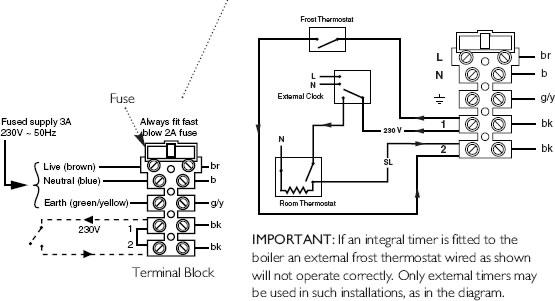

In my house I got Baxi Combi 105 HE for heating and hot water. I am planning to buy "Honeywell CMT927 (CM927) Wireless Programmable Room Thermostat". Is that the right choice? Where can I buy cheap?
Is there any possibility of guiding me so that I can install myself.

Today I checked the manual for my baxi combi boiler. I think I have to buy 4 core electrical cable to do the connection of CM927 with combi.
It would be help it somebody can confirm the connection, which wire going where please.
Yes, you do need four wires to the CM927 receiver: Line, Neutral, A Terminal and B terminal. If you want a single cable you will find that you will have to buy a 4-core plus earth (available from B&Q); but there is nothing to stop you using two twin-cores (without earth) if you want to. Just makes it easier if you have four separate colours.
You wire it as shown in diagram 4b in the installation instructions. L and N of the receiver can connect to any permanent mains supply, including the L and N terminals in the boiler. The A and B terminals connect to 1 and 2 on the boiler. If there are any wires already connected to 1 and 2, or a link between them, remove them; this will disable any existing clock and thermostat. The only exception would be if you have a frost stat (boiler in garage).

Thankyou very much for your swift response. Just confirming, if I get the 4 core wire plus earth, where the earth wire connecting to.
My combi boiler is fitted in the kitchen, so I think it should be fine. Does it means the frost stat will not work? Any complications.
Last thing is CM927 good wireless thermostat? I have not bought it yet. Do you recommend any other or it is fine...
The earth wire is not needed - it just happens to be part of the the cable - so there is no need to connect it at either end. I would cut it back to the outer insulation, so that no one thinks it has been forgotten/disconnected.
If the combi is in the kitchen, you won't have a frost stat; so no complications.
Probably the best wireless stat on the market.
You wrote:
Hopefully the receiver does not need anything else to be fitted on wall.
Make sure follow the instructions about location (page 3, diagram 1). It is also a good idea to check the communication between the two units of the CM927 before fixing to the wall. I did this by attaching a long lead to the receiver with a 13A plug on the other end. It's then easy to hold the receiver against the wall and check it receives OK from the proposed transmitter location.

You Wrote
So this means, only two wires are going to the boiler from the receiver connecting Terminals 1 and 2, and other two from the receiver can be connected to any of the main supply. It is not necessary to connect them to L and N terminals in the boiler.
Please clarify, sorry for asking you again and again.
Hopefully I dont need anything else except screws to fix the receiver on the wall??
That's correct. The L and connections of the receiver do not have to be taken from the boiler; but if you are using a 4 core+ earth cable it is much easier to do so. If you want to use a separate L and N connection it should be controlled by the same switch/fused spur which turn the heating system off
You wrote:
Hopefully I don't need anything else except screws to fix the receiver on the wall??
Just screws and rawplugs, if necessary.

I've been reading this thread and have fitted a CM927 to my baxi 105HE following the instructions, & advice found on this site. I've done everything exactly as per the manual but it doesn'y seem to work! I've removed the link between terminal 1 & 2 and done all the wiring correctly. The CM927 remote thermostat communicates with the reciever & I can hear the relay clicking in the receiver when I turn from 'off' to 'manual' but it doesn't stop & start the boiler.
I've got the switch on the boilers mechanical timer set to the 'I'/constant position but this just makes the boiler on constantly as before. I'm pretty sure I've tried every combination of settings on the boiler panel but nothing seems to make the boiler respond to the CM927, everything seems to be wired & meters out right - I'm thinking that maybe there's something wired wrongly in the boiler or that something else is wrong with it - the CM927 seems to be functioning perfectly well.
All very confusing & frustrating!!
