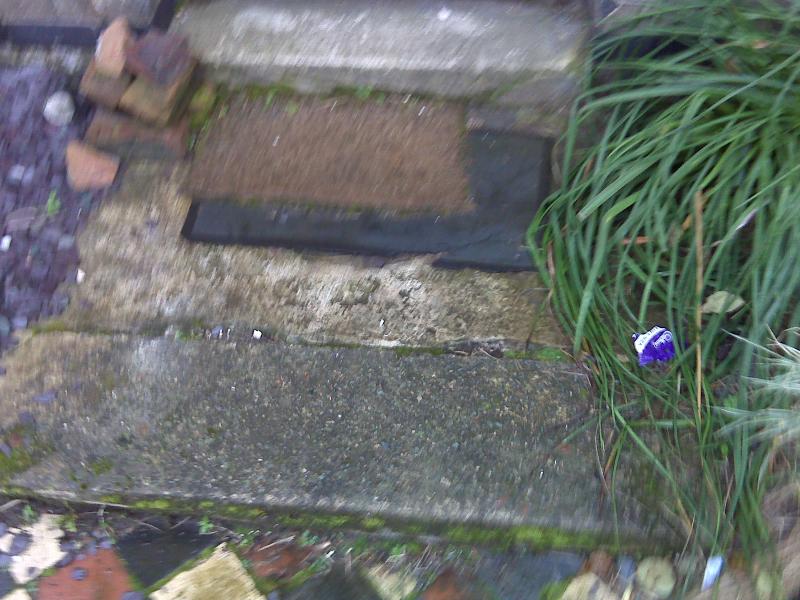

Hi all,
We have a coal cellar in our house which I’d really like to make waterproof and would like some suggestions on how to do this,

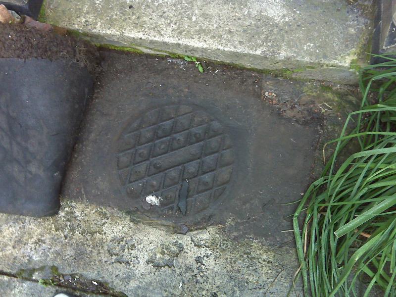

I’ve attached some pictures of the part of the cellar that’s outside our front door and from where the water seems to be coming in.

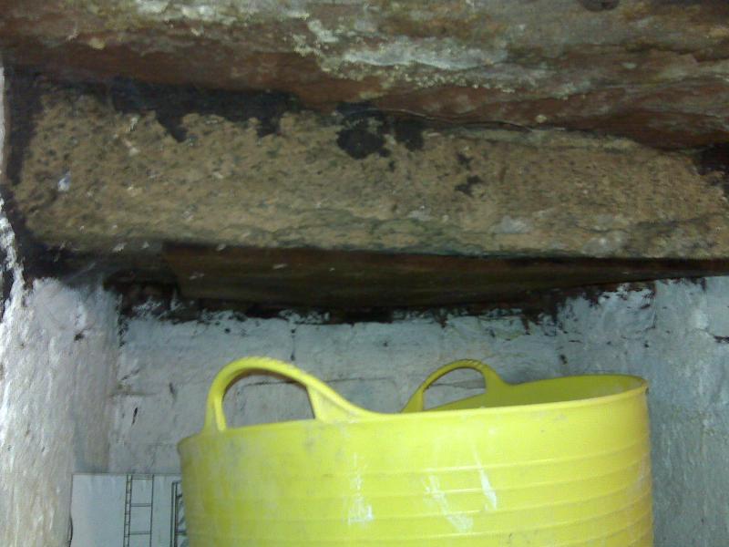

The old coal hatch is still present, but has been concreted in. However, from below the whole of the concrete slab that the hatch is in seems to be damp, the water is dripping from the piece of wood that has been presumably put in place to hold the concrete when the coal hatch was filled.
I’m apt at rendering, and have half a tub of tanking kit left over from a shower project. Would either of these be the routes to take or do you think the whole concrete slab is shot and will need to be replaced?
Any other suggestions of what to do would be welcome too!!
Thanks!
well it depends on what you intend to use the coal cellar for . It will be under the ground and likely to have no damp proof course or damp proof membrane . You'll probably need to put in a DPM and dryline the walls if its damp.

Wont drylining the walls just allow dampness up behind the drylining?
It seems that the problem is the incoming water, which needs sorting out first
good and proper, because if its not done 100% forever then anything done inside canget ruined later on, so I would be removing as much of the slab up top & replacing it all rather than just filling in a little bit.

It looks like the cellar wall already has some kind of paint or coating on it. This will make it difficult to apply a tanking slurry (like the Mapei product you have) without doing a lot of surface preparation - e.g. bush hammering, grit blasting. The easiser method is to use what is called a cavity drainage membrane (e.g. Oldroyd, Newton) - these are fixed onto the wall without any preparation and allow any damp to drain away behind them. Really they should be used with a sump and pump, but if you are sure that your cellar is damp and will never flood you could get away without a sump and pump (at your own risk).
Yes there's a coat of matt masionary paint on the walls.
I think the main source of the damp is rainwater coming through/around the concrete slab on the top of the cellar rather than penetrating damp coming through the walls.
I'll see what I can do with the tanking stuff I've got to hand and feedback for the benefit of anyone else with a similar problem.
