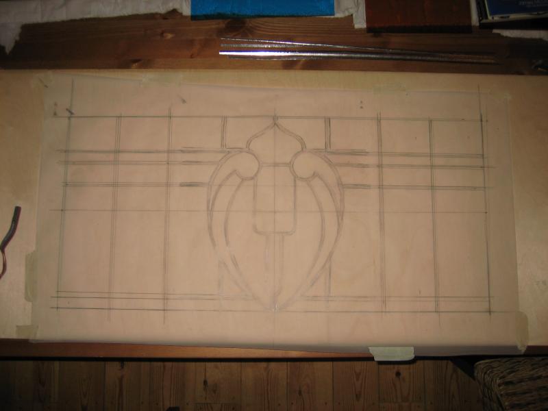

First i made a tracing of the feature from one of the reclaimed glass doors, then pinned it to a piece of ply board and sketched the rest in to make a whole window section, only allowing 1-2 mm for the web of the lead cames not enough at all, also i should of got lead came for thicker glass.... found very hard to fit the glass in without having to open the cames up wider.
Holding the glass in place with panel pins, and placing the cames in position.
Cracked loads of glass trying to cut right angles? i've realised it can't be done the glass always carries on the crack from the right angle point, but a tight radius works.
And recutting the cut glass pieces is not easy, needs to be right the first time... thats where a glass grinder would be very useful and to finally shape the glass.
Soldering wasn't as hard as i thought, looks better from a distance though after all i'm not perfect. but everyone is impressed and thats all that counts.
