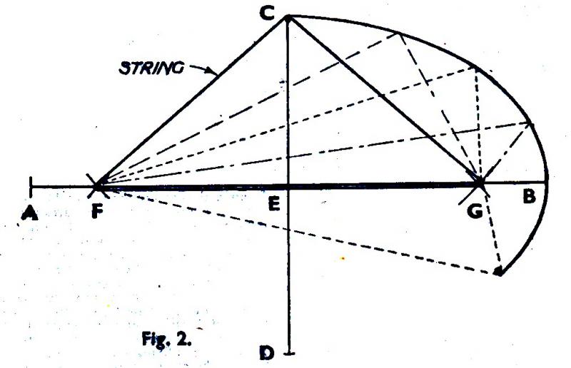

you can do it with two fixed pegs at either end of the arc and enough slack in the string to reach the point you want........difficult to describe but fairly easy to do. have a look on the paving expert site, i think he has some diagrams on there.
As thermo says use 2 pegs and a loop of string round both pegs and a scribe. This makes an ellipse as opposed to a circle but in many cases this is a better alternative as it can be fitted into any size of rectangle as opposed to a circle which fits best into a square.
More good advice - thanks.
emmmm - Thermo, Robert, any chance of an "idiot sheet" for this process? I can't quite get my head around it :confused: :oops:
Jim - like this:
the length of string is FCG. This length can be as big as you like depending on the size of your path arc.
Peg the string to the ground at F & G (focal points on the major axis :cool: )and your pencil (or lump of chalk or your scraping stick) is at C. As you move the pencil AGAINST the string it will scribe the path of the ellipse.
