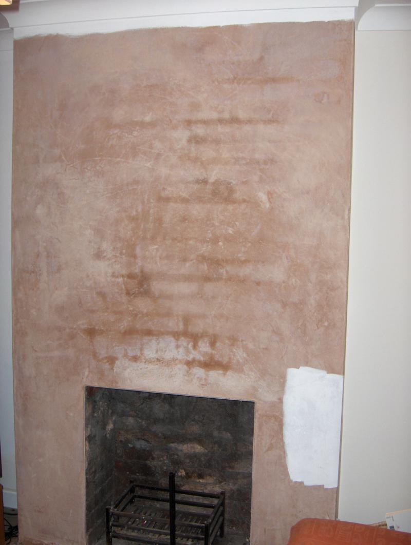

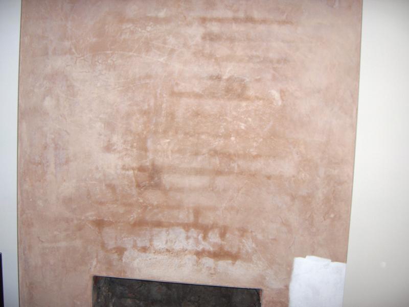

Hi, Latest Saga!
I had my chimney breast replastered about 4 weeks ago, it was taken back to the bricks before being replastered.

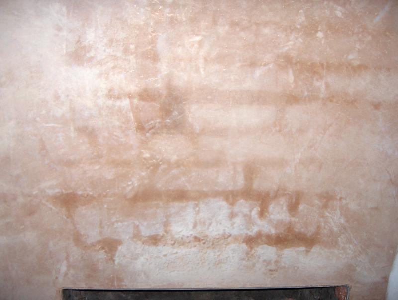

I have noticed I could see the outline of the bricks as its been drying, however, when its wet outside the outline seems to become more obvious, it is almost as if it is more visible and actually damp along the mortar lines?
Is this normal, should I be worried? My initial thought is its condensation but not sure?
I have inspected the inside of the chimney breast and there doesn't seem to be any moisture coming in from the outside and Im guessing if it was trickling down the chimney the upstairs one would be damp too?
It could be a problem known as grinning. If the plaster is too thin, the joints can show through. This because the joints will absorb moisture at a different rate to the bricks. The salts mentioned in the previous post will attract the condensation.

Just a pity that when you took the wall back to bare brickwork, you didn't scratch coat it first with mortar/waterproofer admix , and then plaster. That would have stopped the salts etc coming through the gypsum plaster, which are notorious for this type of problem

The problem with hygroscopic salts is that they will attract moisture in to the wall, even when the R/H is quite low. You will probably find that the wall is always damp and the decorations get damaged. These salts are often found in flues because of the burning of fossil fuels.
Its probably better to sort out the problem now before you install your fire and decorate.

The old plaster may have had a sand/cement render under the plaster.
This can help stop the salts. The new plaster has also wetted the brickwork which helps the salts move in to the plaster.
Was the old plaster defective?
Normally when nitrates and chlorides are in the wall the remedy is to hack off and re-render. But as you have only just had it plastered you probably don't want to do this. There may be a sealer that can help hold them back.
use an s.b.r. and cement slurry mix and paint it onto the masonry.
whilst still tacky, render the wall with a plaster sand and cement mix with s.b.r. added to it. you can add waterproofer to the plaster too.

Both the plasterer and you will know the next time though Reg'. It's always a gamble using gypsum plasters on old brickwork/stonework without "at least" scratch coating them with sand,cement w/proofer first.. One good thing about it though, if your wall gets any worse in the future, eg: paint blistering up, patchy areas appearing on the surface etc, at least you'll know how to cure it,, by taking it all off and starting again. Hope it doesn't come to that but???
Roughcaster.
Reginald - leave it a bit longer, paint it with stain-block, them emulsion. If it shows through the decoration do as other have suggested - remove & start again. If it doesn't ... result.
