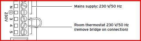

I found the manual and wiring diagrams online, brother-in-law fitted the boiler (he's a plumber) but is worried about wiring the thermostat in case he pops a fuse...
Seems pretty straight forward to me 2 wires to connection 3&4 only problem being which way round??doesn't seem to tell you in the boiler install manual.
Below is the bumph and attached are the wiring diagrams, any help would be greatly appreciated.
The boiler terminals 3, 4 and 5 are for connecting external
electrical controls such as a time switch and/or room
thermostat. Terminals 3 and 4 are linked together when
the boiler is supplied. If external controls are used, this
link must be removed, and the controls connected
across terminals 3 and 4. Terminal 5 is an additional
neutral connection for external neutrals such as from
the anticipator of a room thermostat.[/img]
It doesn't matter you are just creating a simple live circuit which is broken when the stat turns off.
What sort of boiler are you connecting it to, if a combi you should really be using a volt free model which the rst 1 or 2 isn't really designed to be used as.
It is for a combi, I bought a new-build house and have the exact same stat on my combi at home tho??
As you do not need volt free connections, assuming the wiring diagrams you have posted are accurate, you could just wire the call for heat to terminal 4 on the pcb.
This seems to be getting more complex the more replies i get volt free or not volt free, that is the question...? ;)
Will i blow any fuses on the boiler if i get this wrong or will it just not work and i jump 3to4 on the pcb again to sort things out???
Your boiler does NOT need volt free connections for standard external controls.
Either take the switched live from boiler 3 to stat , then back to 4 from stat, or link permanent live in stat to common in stat then just take stat switched live back to 4 on boiler.
