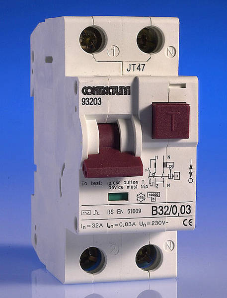

Is it an MCB, or an RCBO (does it have a test button, as well as the up/down on/off switch rocker?)
Does the cooker switch have a test button on it? The reason behind this is that if it's an RCBO (residual current circuit breaker with over current protection) it has two functions. One is to protect against the cooker drawing too much current in case of an overload, the second is to detect a leakage between live and earth as happens when you touch the live parts.

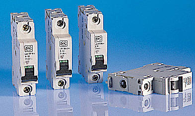

An MCB (main circuit breaker) just provides overload protection.
If there is a leakage current in the cooker it will trip an RCBO.
Here's a typical MCB:
Here's an RCBO:
Does this help?
......................and short circuit protection!!
