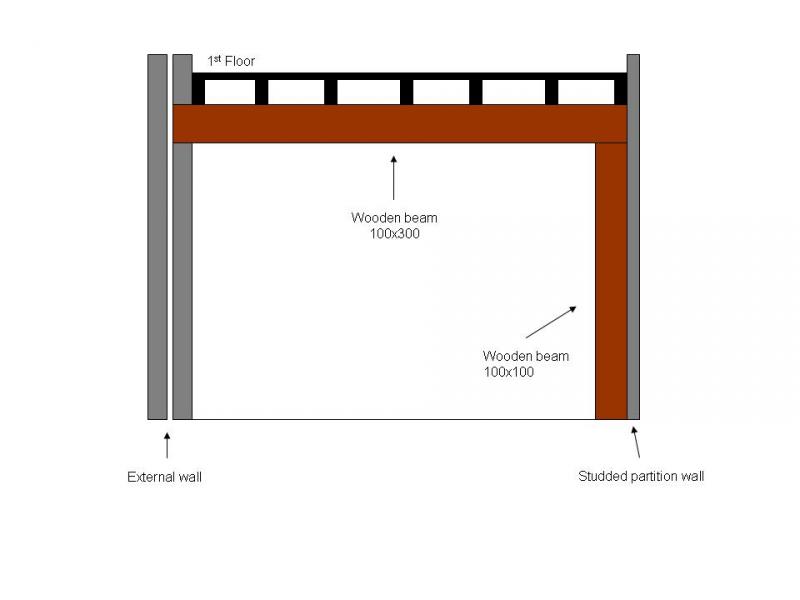

I am going to remove a partial load bearing arch which segregates my kitchen / dining area.
I have had a SE to do the calculations and the plan which I have now received and I have put my application in for building notice but to keep costs down I am going to fit the wooden support beam myself.
I had a good chat with the SE about supporting the ceiling whilst I do this however what I would like to know is the best method for cutting the recess in the external wall for the beam which has to be 100mm deep.
Any other pointers or advice on this would be appreciated.

The beam is going to be longer than the room width and so, the hole for the bearing is going to have to be wider (and deeper) than the size of the beam so that it can be inserted at an angle before being placed in its' final position
Thanks for the replies and advice fellas it is appreciated.
Never thought about the fact that the mounting recess would have to be bigger due to the length of the beam. On the plans it doesn't have a padstone. If I make the cavity longer than required to get the beam into position what is going to be the best method to bring it up to the required height when fitted?
The beam will only be marginally thicker than the existing top bar of the arch that is fitted at the moment so head clearance won't be a problem. The SE recommended a wooden beam because of the fact at one end is a partition wall and he said it would be a better method due to the issues with supporting the beam at that end.

A timber section that size has a good chance of splitting and twisting if it is not allowed to aclimatise to the internal air for a few weeks. Even then it may twist or split as it does so.
So there is no way I can leave this beam exposed by finishing it other than covering in plasterboard? This was not part of my plan and if that is the case then that is a bit of a dampener. Also the SE never stated it would have to be clad, and even chatted about it be an aesthetic feature once done!
Is there no where I can get a properly treated graded wooden beam custom for the job that is not going to warp and twist and require cladding in plasterboard?
You need to chat to your engineer.
I would suggest that it is part of the engineers job to design a beam in accordance with applicable regulations in mind, which would include one that stays up for a while if there is a fire
I don't think that building control will let a structural exposed beam be unprotected in terms of fire.
You can get chemical treatments, but they are expensive
The problem with a 300 mm deep timber section is that there is a lot of it unrestrained, and so as it starts to dry out and acclimatise it may start to twist and it can split along the grain. Timber is natural, and so what happens is unpredictable.
So whilst the engineer may have considered this purely as a mathematical exercise, and calculated a suitable beam to take a certain load, he does not appear to have considered the other aspects of "the design" in terms of practicality or suitability.
The beam might be OK with fire regs. If you look at modern post and beam construction houses there is a lot of exposed structural timber.
A thick timber beam is said to perform better than steel in a fire which deforms quickly in the heat.
