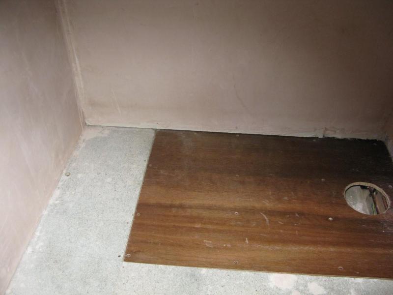

the floor feels solid even the last bit that is chipboard, i'll take a picture of it tomorrow it's always difficult to try and explain and for people to see what you are getting at without seeing the job icon_biggrin.gif

PostPosted: Thu Feb 19, 2009 8:26 am Reply with quote
hope it works, here is a picture of the floor as you can see the last bit is chipboard the floor feels solid enough so hopefully will be ok
it's a tight space so will be awkward to lower the tray evenly onto the floor ,also do i have to use enough cement mix that it goes into the channel that runs around the edge of the base, this is the base i'm using.

PostPosted: Thu Feb 19, 2009 9:37 am Reply with quote
That looks like a lump of old Sapele door or part of your grannies old headboard icon_eek.gif no wonder youíve got a 4mm run out! I wouldnít bed a stone resin tray on that; do it properly, take it & the crapboard up & replace it with a full size WBP ply base board.

PostPosted: Thu Feb 19, 2009 3:15 pm Reply with quote
tali - I'm with RichardC on this one - spend a bit of time taking that bit of ply up AND AND AND that bit of chipboard which'll be under the tray (at least). What you should really do is to remove ALL the chipboard in the room and sheet with exterior grade ply (at least 18mm thick WBP). What are you going to finish the floor outside the tray's footprint with? Tiles? Even more reason to bin the chipboard. Leave the chipboard and you WILL live to regret it.
It doesn't matter that one of the wall sits on that bit of c/board; remove by sawing/chiselling as much as possible away, then reinforce the structural timbers by 'sistering' the joists and adding noggins (sistering is where you glue/screw additional timber {say studding or similar} along the joists. By doing this the edge of your new ply floor will rest, and be fixed, to structure. Doing this will be time well spent, maybe Ĺ a day!
Mortar mix can happily go on the WPB ply and only needs to interface with the tray edges and base - you don't need to fill-up that "channel". The aim is to provide support directly below where the load will be.
Tip: how to successfully lower the heavy tray onto the mortar bed without dislodging or disturbing the mortar. Use 2 lengths of nylon cord looped around the tray (one at each end) to form lowering handles - this will guarantee the thing goes down flat. When you're down undo the knots on the rope and pull them gently free. If you're big and strong with a back in decent condition you could do this yourself, otherwise rope-in (sorry for that pun) an able assistant ... maybe Mrs Talisker.

PostPosted: Thu Feb 19, 2009 8:37 pm Reply with quote
ok i accept that it's a crap job i just thought it would be better than sistering the joists but i guess you guys are right it's a job i only want to be doing once so i want to get it right, i'll order some WPB ply on monday and replace the whole floor it's an ensuite so it's not a large area.
what about the mortar mix does 5 to 1 seem right ?
