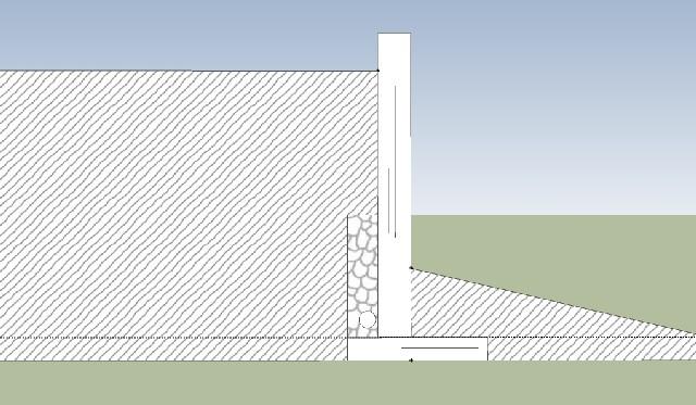

Hi See below

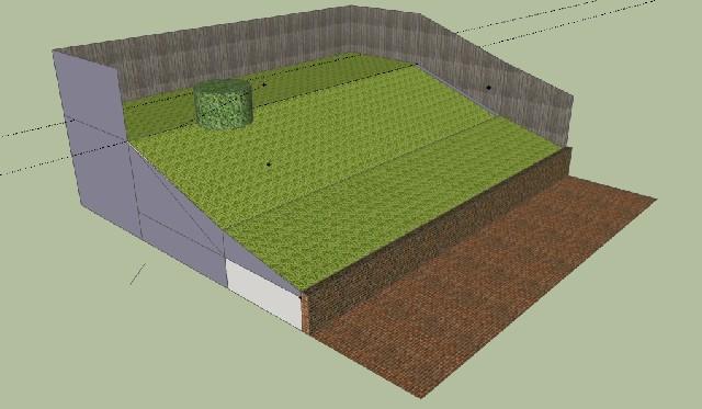

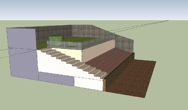

The cross section of the wall is a design I was given for a 2.4m wall, using hollow blocks reinforced, the foundations 900mm with 500mm out front and a 1m re-bar running through it and up into the slab and also has a reinforced mesh across the whole of the foundation. This is a lot bigger foundation than I was planning but makes sense.
It will also have a horizontal reinforcements around the sides and into the return walls running 3.8meters back (as in diagrams) which will help hold it back at the top and mid way down.
In fairness the desgin I was given had a stone cladding front to it but I'm not sure if that actually adds to the strength. I am trying to find out if it does at which point I could include an run of 100mm blocks on the front, maybe not the full hight.
To finish the wall I'm planning on a sand stone colour render.
All thoughts welcome, naturally

Ok, I can see the logic behind this system.
To make it work best - use Ø10 or Ø12mm reinforcing rods and bend the ends to give yourself a 300x1200mm "L" bar. Sit the short leg on you mesh when you concrete the foundation - use a bit of 4"x"2 or similar to keep them in line/vertical. aim to have them at about 150 crs. At the front edge of the foundation dig a 300mm wide trench an additional 300mm deep - this "toe" will stop the whole thing sliding if you get the sort of deluge we've all being suffering the last few "summers" Stick a strip of mesh vertically in it.
Use brick reinforcing mesh in the mortar beds for the height of the vertical bars.
As I put in the other post - take a lot of care with the drainage - wrap any stone in a geotextile - terram or similar and leave weep holes. It is water that causes most failures in retaining walls.

Thanks Paul, very usefull advice, I definitely tink you are right about the 'toe'.
The drainage is going to be quite hefty with 2 cubicmeters of stone and 110mm drainage pipe as you say. I actually hope to catch the run off to use in the garden.
