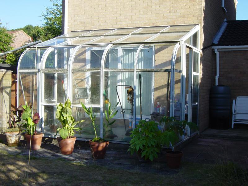

Hi Rizred, spooky mate!, I am also at the beginning of a self build conservatory, and your existing lean too looks just like mine!! :eek:
I recently posted a message to ask if anyone has any ideas on how I am going to get my old one down!!
It looks identical to yours but looking at it the glass panels seem to fixed using hard rubber not silicone....
