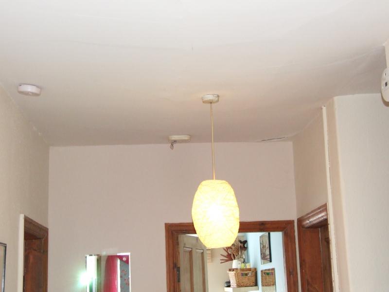

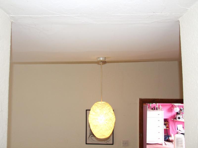

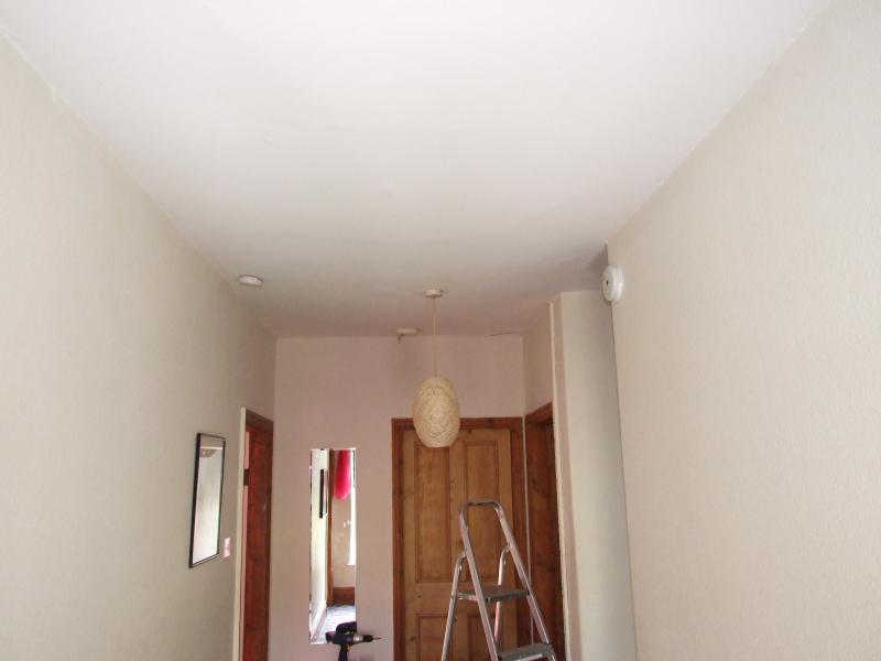

When we bought the house the upstairs ceiling had a noticeable sag and when we questioned the vendor she was vague other than saying that it had been like that for as long as she could remember. She did make noises that it had been like that since the roof had been re-slated. When we bought the house we had a full survey which made no mention of the ceiling or roof.

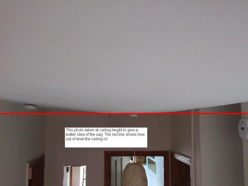

What is concerning me is that the bulge/sag is now approx 8 inches deep. I don't know whether it's paranoia or not but it seems to be sagging more now than it did when we moved in.

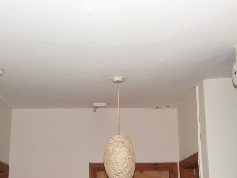

The first pic shows (I hope) the sag. If you look at the smoke detector on the left you can see what an odd angle it is at. The low point is where the light is. There is also a crack in the back right of the pic that has definitely opened up slightly, maybe 5mm or so.

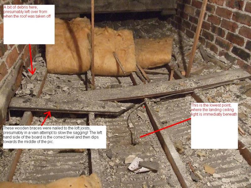

And finally the loft area. Note the supports which appear to be holding the ceiling up!
Is it likely to collapse ? I've got three kids and having the ceiling collapse on them obviously worries me!
It's quite hard to see a ceiling bulge exactly on a photo, but 8 inches is a fair amount. The lathes could be breaking away from the joists, or the plaster could be coming away from the lathes. If you go into the loft and move some of the insulation you should be able to see what is happening. Either way I would get it sorted as it will only get worse.
we've had to replace a couple of ceilings in our house - old lath and plaster - due to sagging, albeit not as much as 8 inches :confused: just down to age and the plaster debonding from the lath.
Its not a massive job to rip down the open and put up new plaster board - although I did leave the replastering to a professional - very, very dirty job though - if you do it, be prepared for the mess ;)

I hear what you are saying about the lath and plaster coming away from the ceiling joists , but I am worried that the ceiling joists themselves are dropping with the lath and plaster still attached!!
Hopefully these pics will help
can you put a length of wood across those roof joists to show it they too are sagging as much?
That might show if it's the plaster or the ceiling joists.
Either way, it does look like you need to seal the room & pull the lot down, repair & replace. The last thing you need it it all to fall on you, your family or guests suddenly.
the ceiling was this bad when you bought the house and your surveyor didn't pick it up - there should have been recourse there as its obviously not right.
easy enough to replace the ceiling joists if these are out of level - have you stood on them when i the attic? do they move? Whilst the repair should be relatively straightforward, there must be a cause - could be someone previously removed supports to the ceiling joists and the weight of the plaster has mean they have sagged?

I was thinking along the same line as JohnD, and the extreme length of the span. Looking at the picture taken up in the loftspace, i think you can rule out that the plaster is coming away from the lath. I still think that the joists are a big part of the problem, they look, (in the pic) inadequate for the job, even though they have been there for years. Maybe other supports have been removed in the past. Even with the weight of all the old plaster being removed from the ceiling, i think there would still be a fair old sag in the joists themselves.

I think it unlikely you'll fix it, but if I had a go I'd do this.
In the loft where you have your boards you insert a joist bearer (a thick chunky type of purlin that lays across the joists set into each wall). You then drill a hole down through the bearer, down through the joist into the room below.
You get some 12mm threaded rod a fasten a large repair washer on the end with a nut. Feed the other end up through the hole you've drilled and put a repair washer and nut on the top side. Use a ring spanner to tighten each nut from above (you do the same for all the joists) and tighten them sequentially. If you are lucky the gearing on the threaded rod and the leverage of the spanner might force the sagging joist back up to the joist bearer. If nothing else it would take any future load.

As a quick cheap fix only to stop it going any further I was thinking of running some mild steel flat bar down to the joists and bolt to the support beam currently in situ. The only snag i could see is that I would have to drill the ceiling joist from the side and bolt through it (See awful piccy below). This would mean that I wouldn't have exposed nuts/washers on the ceiling below.
The reason the joists go that way, you muppets, is because the joists are used as restraint for the rafters, i.e. triangulation. It's how you build a roof. :rolleyes: :LOL:
As Joe said, a 6" x 3" or 7" x 2" ceiling binder between the walls and above the joists will help stiffen the joists and prevent any more sag.
A couple of fixings down into each joists through the binder will be enough.
