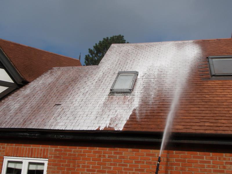

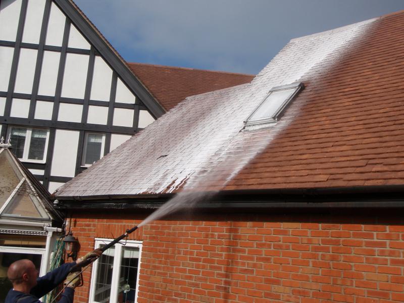

It is best to remove the moss first and then treat with a fungicide. You can then install a copper strip to the roof if you wish.
I use Abicide Fungicide Wash on roofs but I have heard Mossgo is also good.
Check out moss photos on my profile.
