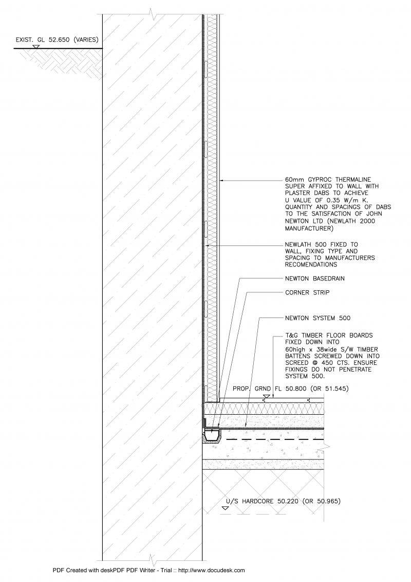

No, he ought to:
Ensure the overlap is what the manufacturer requires.
Ensure the overlaps are sealed properly with the correct sealant.
Install a floor gulley and means of draining or pumping out the water.
Install a floor membrane and seal it against (in front of) the wall membrane with the required overlap and ensure any overlaps are sealed properly with the correct sealant.
Make sure any penetrations through the membrane are done so using the manufacturers methods/own fixings.
Fix enough insulation to ensure the walls achieve the U value stipulated by Building Control.
Edit: this is roughly what the detail should look like at the floor/wall, this is from a job I did about 4 years ago with a different manufacturer but the principal is the same.
