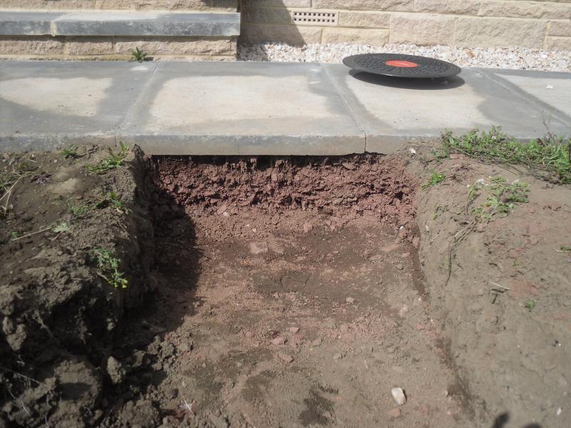

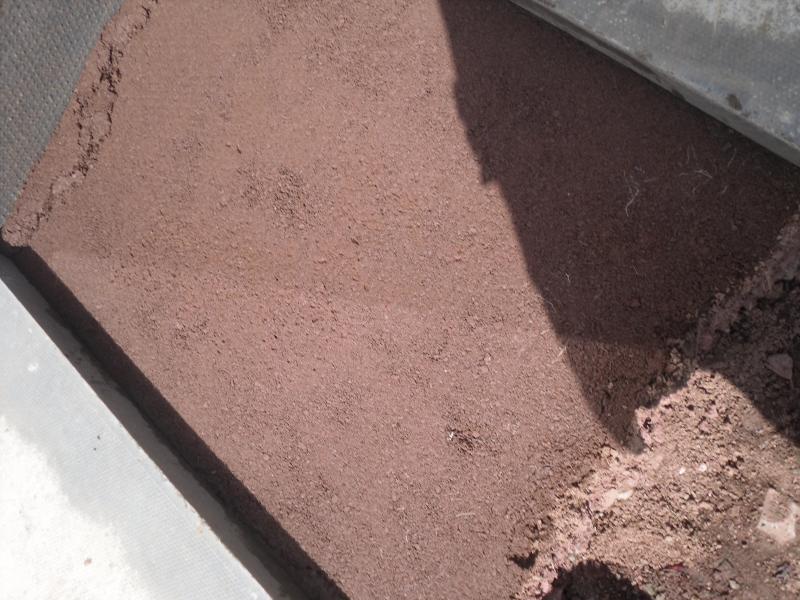

the plan is to mortar the flags down. i've started to roughly dig out the area today. im finding that theres more stones than soil. i also dug down at the area where the people who built the house had laid slabs,and found that there is a base of what looks like mot and a layer of what looks like sand on the top
im not sure if i need to remove the sand,or if i can leave it,it would be great if i could leave it lol.
not done ,manual labour for a while i've got blisters n back ache lol.
heres a pic of whats under the slabs.
I watched the guys laying my slabs and they mortared the slabs straight onto the hard core after it had been compacted down twice. i can't comment on the base you are showing in the pics as not enough experience. In saying that if it was me everything would come out and i'd start again so i knew it was done right. I am sure someone will be along soon to answer you!
