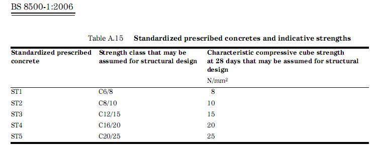

Can anyone tell me how to determine what ratio this is ?
I have read that ST2 is C20N which is 4:2:1 ?
What does the S3 part mean - is this the slump by any chance ?

New european way of defining slump ( or flow if using piling concrete )
S1 = 0 - 70mm, S2 = 30 - 120mm, S3 = 80 - 180mm, S4 = 140 - 240mm and S5 = 200mm+. These ranges are for spot samples taken on site in accordance with BS EN 12350-2.
ST2 is the equivalent to the old C10 mix
The mix ratios that you have are approx 3.7 : 3.0 : 0.9. give-or-take
HRH
As above ST2 is the old C10 or 1:3:6, so your mix is a bit stronger than that as it's nearer 1:2:4
Cheers Denso13
By any chance could you tell me what ST3 and ST4 used to be together with their ratios.
