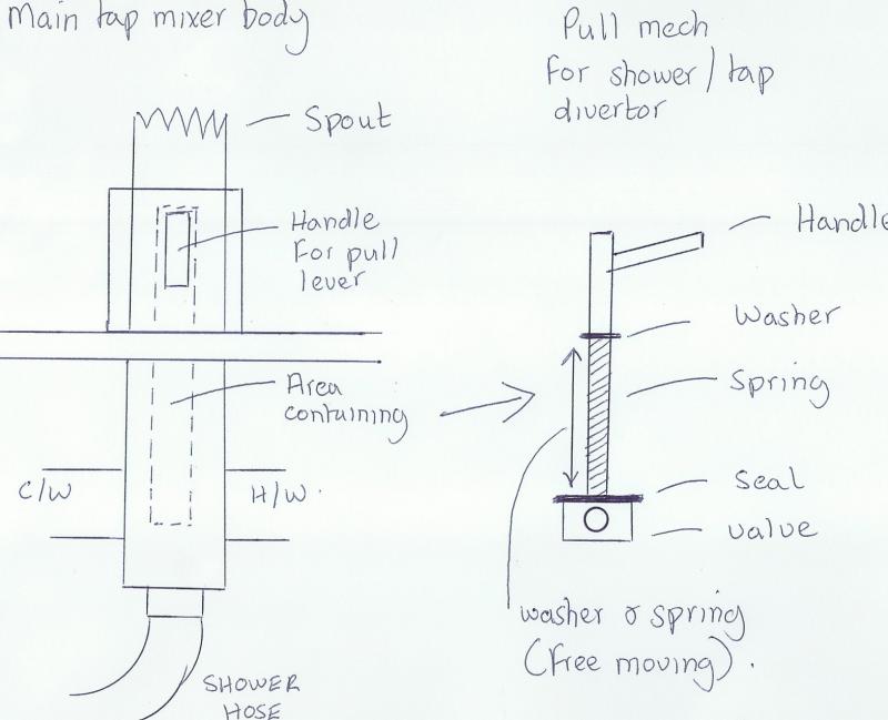

Here's my basic drawing (my visio is knackered).
When the pull for the shower / tap is in shower mode it works fine. The seal above the pull valve seals the water from the tap spout exit and all is good.
When the pull is in the tap mode, water comes out the tap AND out the hole where the pull lever handle is.
There MUST be a seal that's gone awol, I suspect the seal has perished and should be located above the spring and washer on the pull mech body.
For a seal to work and allow movement of the pull upward and downward I'd 'imagine' it was a top hat type rubber washer with a hole in it for the pull mech shaft to have the necessary up / down movement.

Although I'm not sure I fully understand, it sounds as though there is an o-ring missing from the shaft you describe, which should sit between the top of the washer and the housing above it.
I am afraid that you are asking a lot. I cannot tell you from your
drawings exactly how your mixer is built. I assume that there would be an "O" ring seal between the water body and the surface but, unless I took the thing apart, I couldn't tell you where it would be. I'd have had to chuck out three or four high ticket taps over the last few months. They were all only a few years old. They are lovely and heavy for the tot box but the seals etc. are really poor quality and design. Nice looking pieces of carp really.
On the other hand, it seems fair to say that no water should be getting beyond the seal that lies on top of the valve in your drawing, anyway. So this looks as though it has failed through usage, which I assume (er guess!) moves up and down (or rotates - not quite sure which one) inside the brass casing as the lever is operated, and it is this sliding action that has worn it away. If you can get a replacement from somewhere, it sounds like it's going to be a recurring problem during the life of the tap, so get a few!

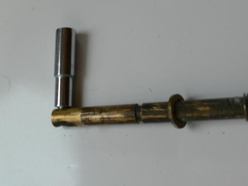

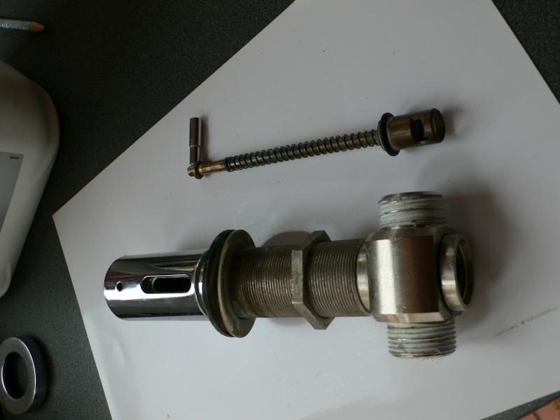

Here's a picture of the old and failed body
The mixer shaft is on the LHS having been removed. As you can see in the next picture with the shaft spring pulled back, the shaft has an indent which should house a rubber ring seal.
So the shaft should have a spring, then a washer and finely the rubber ring seal.
I'd imagine a seal costs less than 1p to make and less than 50p to buy at the right "old world" plumbers merchant.

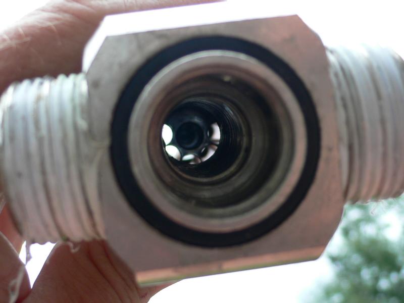

For any that doesn't understand the importance of the seal, the picture below is taken looking up inside the main mixer body.
The outer holes contain the water flow to the spout and the centre hole the shaft, spring, washer to operate the mixer.
So for the sake of a very modest outlay, should similar happen to you you can save £330 and spend 50p on a rubber band :eek:
