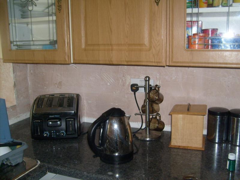

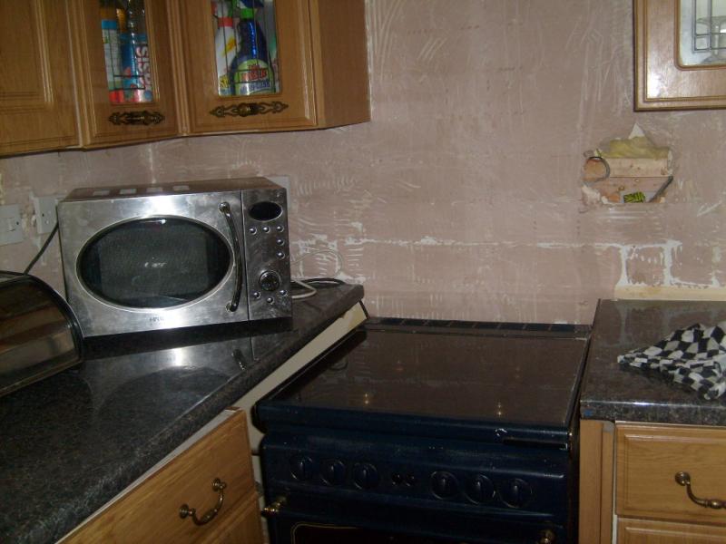

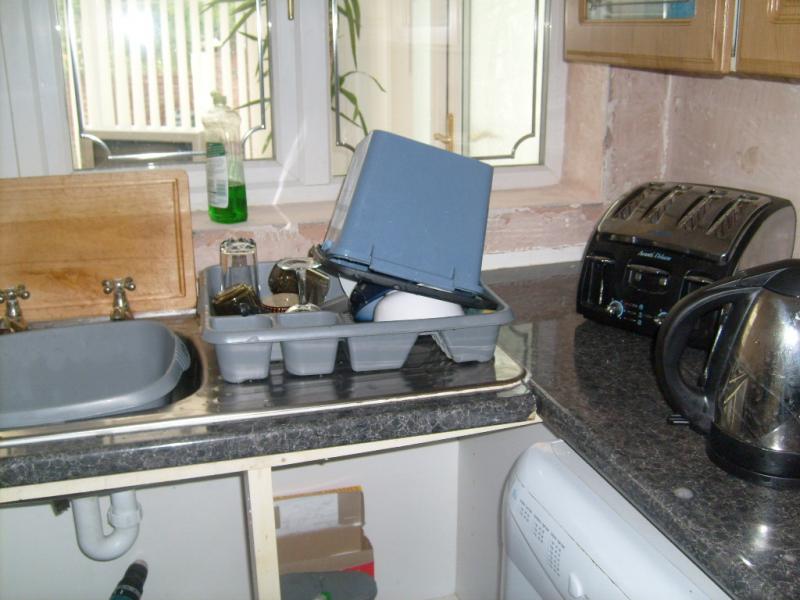

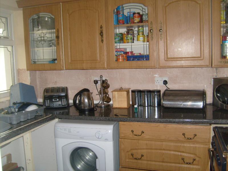

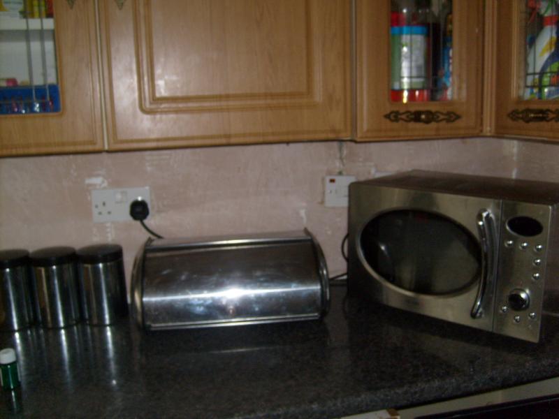

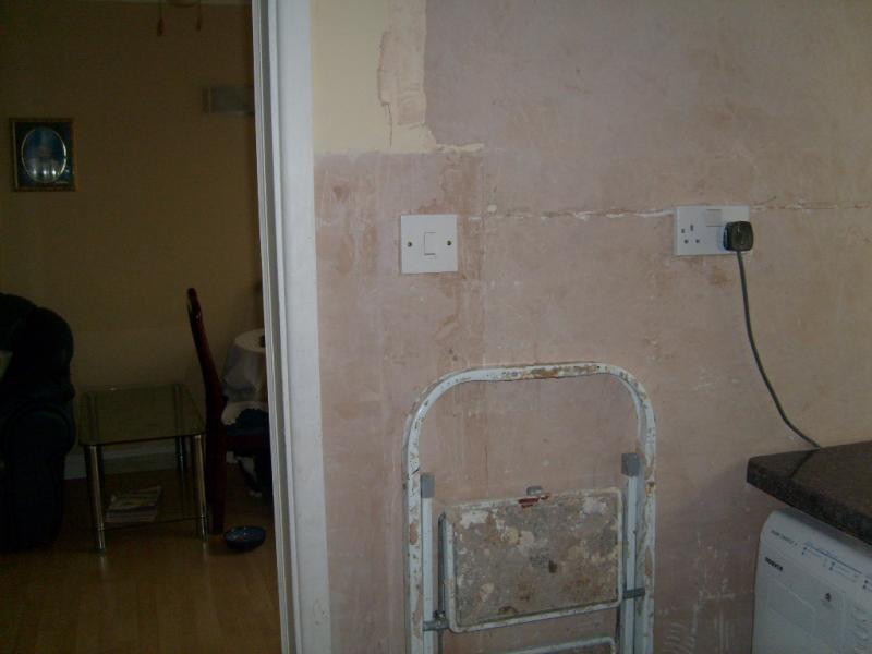

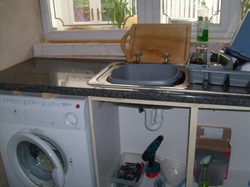

As per the title I am doing my kitchen but am not very creative so would appreciate some ideas.
The pics below will give you an idea of current layout which I wish to change completely.
The room is 2.7 metres by 2.16,
Any ideas welcome and will post as I go.
I recon you're best off sticking to the current layout..
try a combined WM / TD.. frees up space but means you can't dry one load while washing another..

could take that window out and extend into the conservatory for a "breakfast bar" type thing..?
or block the doorway and have the conservatory as a kitchen / breakfast room?

Only thing I would change is put the cooker on the r/h side with a work surface either side.

Really need to see the overall layout & think about how you use the space, you can walk a surprisingly long way in a kitchen & you don't really want to make it worse by a bad layout. I thought the cooker was on the L/h side but having blown up the pics, I can see now it's right down the back! Presumable that run of units is on the 2.7 meter side? Where you put it exactly will depend on other factors such as location/availabitlty of sockets & other appliances & the availability of an external wall for a decent extractor fan which you should have (&, again, is a BR requirement on new & major refurbishments). Having a good section of work space either side of the cooker for food preparation & somewhere to put pans when cooking is ideal. It's also good to have space either side of the sink & take advantage of natural light so I would probably leave that where it is.

I'd like to see the cooker in the middle of the back wall - where the dryer is (or the appliance under the kettle if its not the dryer)

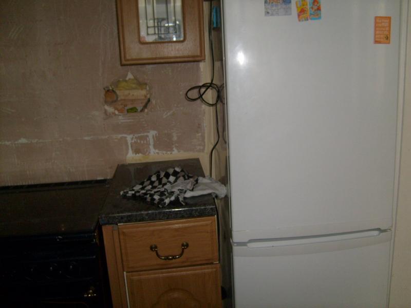

Its a very tricky space as it is. I also dont like the fridge freezer. I'd like to see under counter appliances in such a small room - the FF dominates the room.

Open plan is a no go as it is a bungalow with a dormer on top and the wall is holding up an RSJ.
Fridge is too big as well as you point out.

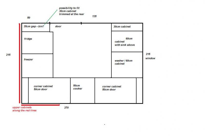

knock a quick sketch up of the layout on microsoft paint...you'll find it;'ll increase the feedback as the photos arent helping!
here you go mate, stuff B&Q, have a gander at this!
spent way too long on it lol. with the dimensions you gave it just fits, there is margin for error on the cooker wall, because the corner cabinets normally have a void at the back corner, but the other two walls only have 5mm margin.
