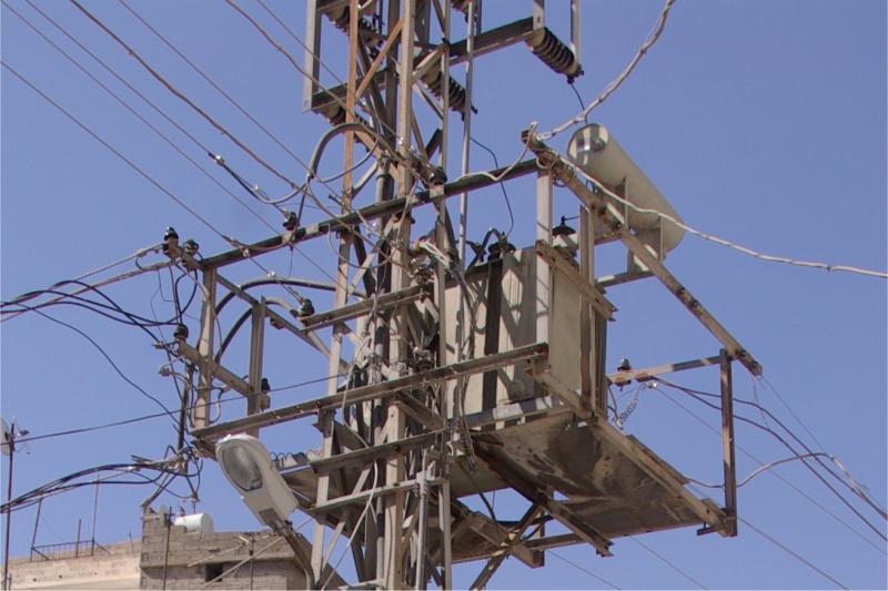

Because we have now 230vac dropped 10 volt to line up with Europe we have large transformers which produce 3 phase with one phase being feed to each house in turn so you will be on same phase as 3 doors up the street.
However the USA use split phase and a single phase transformer is used to supply just half a dozen houses.
Some places with 230vac also use the small transformer method this
is in Turkey where 3.3Kv is feed to small transformers which then supplies 230 to the dwelling more than in USA may be 20 or more flats from each transformer but less than UK.
USA still have 220vac into each house with one leg upstairs and one leg down stairs and both to the cooker.
not always true.
our street is supplied in banks of 4 or 5 houses.
theres 3 phase supply under the pavement. every 4 or 5 homes takes a single phase from this and its daisy chained to the 4/5 homes. Not directly through cutouts, but around the outsides of homes with spurs off. All done in concentric / seperate twin / combined twin oval cables.
terrace homes are often done in pairs, as the supply is under the stairs and two staircases will be side by side. Or the supply is next to the bay window in the lounge, as is next doors etc.
