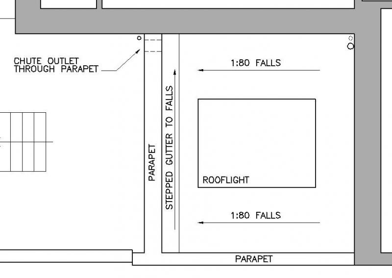

I'm drawing up a lead flat roof. (Its a square extension built off 2 existing walls with a parapet wall to the remaining 2 walls - see roof plan below)
Reading up on lead detailing seems to require that a lead flat roof (min. 1:80) requires ventilation of 50mm below the deck. The makeup for the roof I'm proposing is as follows:

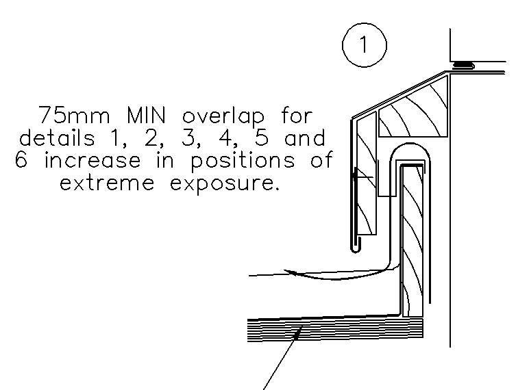

I was planning on venting it from back to front (along the pitch) now assuming the above sounds ok I've found a detail (see below) for venting at the top of the roof where it abuts the existing house external wall, at the lower end I have a small parapet which obviously also needs to be vented too. Q1 Do I use the same detail or is there alternative?
Vent detail
Realistically I appreciate that any decent lead worker will be able to detail this ok but I'd like to understand how the detail works.
Q2Alternatively could I just vent the roof from side to side and use this vent detail at each side instead? and Q3 Do I have to vent round the rooflight as well?

Answered my own queries with a 2 minute call to the Lead Sheet Association :rolleyes:
Q1 Yes
Q2 Yes
Q3 Yes
Q4 Because its lead and impermeable.

The detail you have shown is easy to achieve. Just leave the ply decking and 1" short of the wall / abutment, using say 80 mm screw attach a batten (2" x1") along the line of ply and then another on top giving you the 4" upstand. Once the roof has been laid with sheet lead, screw a 3" triangular length of timber to wall , incorporate insect screen and add sheet lead flashing. It may add a day to the job and cost an extra £80-00 in timber and wider lead flashing. Good Luck
