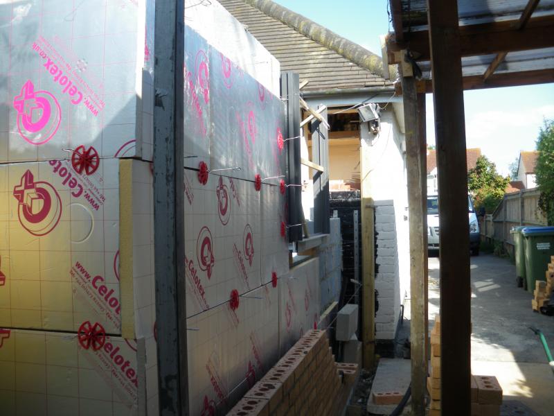

I am doing my first cut roof on our extension to our bungalow, but can forsee a problem joining our new extension roof to the main roof on one side.
Where the new extension meets the origional building there is a small set back of about 400mm, the reason for this is to give more room to get in and out of the car under the car port next to the extension.
As per the pic
This will put the valley on this side close to the hip tiles and i do not really want to have to take them off to make everything water tight.
I will if i have to but can anyone suggest anything ?
Basically i will have about 1 or maybe two tile widths between ridge and valley, on this side the other side is fine

Once you get your head around building the roof, i.e. fix the lay boards onto the existing roof so that you can fix the jacks to the lay board, you will realize that it is not possible to build the roof whilst the exiting ridge tiles are in place.
They will be in the way of the valley board for one!
The sooner you get your head around removing the hip ridge and neighbouring tiles, the better.
Provided the new roof pitch is identical to the existing, then there is no reason why you can't use valley tiles as opposed to lead.

Have progressed today, and the pic below shows progress mid way.
I have fitted all valley jacks this side, and i have run a vee of felt 1000mm wide between the main roof and the new roof , bringing the breathable membrane from the new roof over the vee to the existing roof.
I think i have to remove the tiles of the origional roof, and the plan is to remove the tiles back so as to allow the 500mm vee of felt existing roof side, to go under the existing roof felting.
Then re batten, and fit valley tiles over.
Both pitches are give or take 41 deg
Can you see any issues with my plan or have i lost the plot completely.
