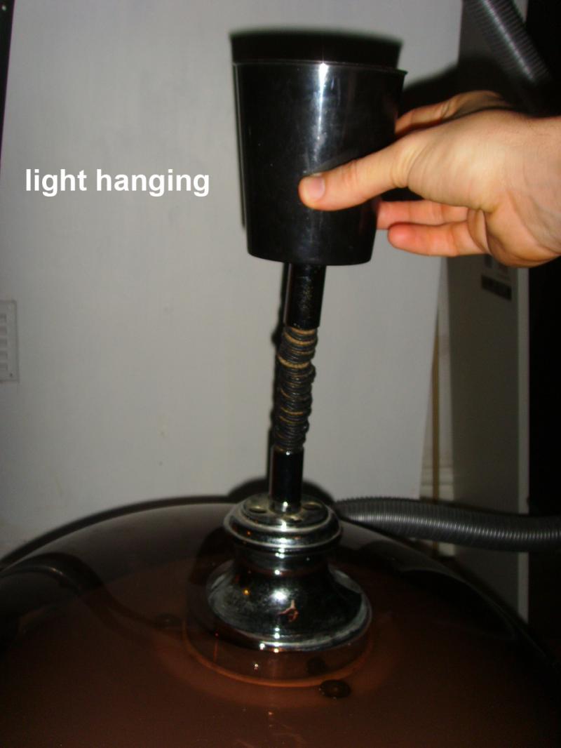

Hello everyone, I have taken off a 1980s pull down light and want to replace it with my own 1960's pull down light there are only two wires coming out of the ceiling red and black (mid vic terrace) but there seems to be a coil of copper wire aswell attached to nothing ?
The light I want to install has a metal pull down handle (so did the old one that seemed to work fine) and three screw in bulbs, I am worried that it will be unsafe to pull, change bulbs etc! can anyone shed some 'light' on this ?
Sorry about the pun!
what should I do, bite the bullet and just install a plastic normal fitting?
or is there any way I can make the pull down work safely?

It does sit in a grey outer and in between the red and black and is solid.
I have now added a album of images.
many thanks for this...
Can't see an earth terminal....
But there is an earth available if you should need one:
So why should it not be safe to touch the handle of the light or change a bulb?

the scrunched up bare cable is the CPC, or earth. this should be sheathed in green and yellow sleeving and terminated in a connector block. There appears to be no earth connection on your new fitting although on a seperate matter it is worth noting that if it takes an eddison screw lamp it is VERY important that the live (red) wire is connected to the cable in the light that goes to the center pins.
Assuming all three centre pins are connected together.
It looks like the screw cap holders are inside metal tubes without any insulating sleeve between them and the tube so this item is almost certainly not double insulated. Therefor the metal work does need to be earthed if it is to be safe in use.
Carbonised spider remains between holder and metal work could make a connection between lamp holder and the metal work.

If the light is double insulated it should not be earthed.
If it is so old that it is not marked with a DI symbol AND it does not have an earth terminal then it should not be used.
