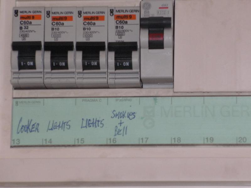

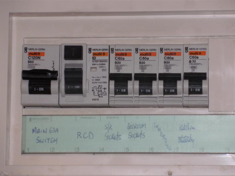

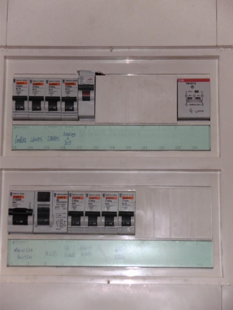

Hi
iam just wondering is it possible to wire a outside double plug socket on this fuse box directly from a trip switch Fuse box
Fuse box
Trips bottom
Trips bottom
Trips top
Trips top
or can i come off an existing one inside. Also what type of wire should be used for the outside socket. Outside three core flex/three core hard wire/or outside heavy hard plastic coted wire. Any help would be appreciated

iam just wondering is it possible to wire a outside double plug socket on this fuse box directly from a trip switch or can i come off an existing one inside.
I think you mean can you add a new MCB and supply a socket direct from that?
If so, then yes you can. You would use 2.5mm t+e for the internal run and then a suitably rated outdoor cable for the outdoor section. This would be on a 16 or 20A MCB. An outdoor socket like this.
You could also spur one socket from an existing socket on a ring if required.
If the wiring is going to be exposed but above ground level you could use 2.5mm˛ hituf.
Make sure you use Merlin Gerin MCB's - the same as you already have in your CU. While you're at it, swap that right hand MCB from the top row with a suitably rated Merlin Gerin one. It looks like whoever fitted the existing one cut the CU cover to make it fit. icon_eek.gif icon_eek.gif icon_eek.gif
You'll probably find you need a new cover too as a result of their exceedingly crap workmanship.

Hi iam back again just want to pick your brain again i have wired up the socket. And fed the wire in how do i get power to the mcb. Do i loop a live wire from another MCB does it matter which one. And do i loop from the bottom and then out from the top to go to the socket. I know how to wire the earth and neutral. Another thing does it matter were the neural wire goes on the neutral blocks. There are two in the box
Back to top
 Alert Moderators
bongos
from United Kingdom
Joined: 07 Jul 2007
Posts: 1004
Location: London,
Thanked: 78 times
PostPosted: Wed Dec 16, 2009 9:12 pm Reply with quote
I'm a little confused by your description! The MCB clips onto the dinrail. Once its clipped on the live feed is directly from the busbar into the MCB. You should not need to loop anything or add any wiring - the live feed to the socket is the only cable entering the MCB.
The neutral/earth should be terminated in the correct numbered terminal for that circuit. The neutral has to go to the correct block or the RCD will trip!
Maybe a pic of the inside of the CU might help.
Back to top
 Alert Moderators
irishturf12
from Ireland
Joined: 18 Dec 2008
Posts: 20
Location: Ireland
PostPosted: Thu Dec 17, 2009 1:56 am Reply with quote
Yeh i see what you mean mine definatly has a live din rail. Mybe the chap in the shop thought it was a older type were you had loop the lives instead. Anyway thanks for your help again.
