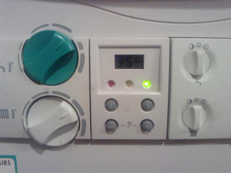

Hello, hoping someone can help me :D
I'm quite sure its a turbomax. The temp is between 31 and 41.
Nothing seems to happen when I press the '+' button on the front of the boiler.
I have pressed the '+' and '-' buttons at the same time, and this does get the temperature up, but I don't know what I should press to keep it at the desired heat ie '67'. To stop the temp going too high I press the two buttons together again, but this just makes the display stop flashing and goes back down.
Any suggestions?

The temp shown is the hot water which will increase as water flows through the boiler. Turn a hot tap on half way and watch the temp go up.
If you want the water a bit hotter turn the green dial a bit more clock wise. :D
Wot are you trying to achieve :idea:
:D I'm trying to get some heat to the rads, they are all on, but not hot enough
I thought the obv thing would be to press the '+' button to increase the heat.
I do have the contract with the gas board so can give them a call, was just hoping to sort it myself by pressing a few buttons, if I just knew which ones to press!
I would of thought that the obvious thing would be to use the dial with the radiator picture next to it! although it appears to be set high enough already, its possible the spindle is broken inside. Where on earth did you get that green knob from? :confused:

thanks I have notice the temp go up when I turn a hot tap on I wish it would stay that hot for the rads.
Should have said that those dials don't seem to do anything - they just turn but when they are turned I can't acutally feel any thing moving IYSWIM
I thought maybe someone would be able to say, 'ahh yeah, I know what she's on about' and be able to tell me which button to press after I had pressed the plus and minus ones together, to keep the temp.

yep I think the spindles are broken...... The green knob was bought by my husband when he was here. would say he's a biit of one himself, but am only a newbie and don't want to get banned lol :D

Well if the spindles broke your stuck. Pressing buttons won't help, they're just there for servicing and diagnostics.
nb: I've never seena green knob on a turbomax plus and can't imagine where its come from! Painted??
The temp,s are controlled via the thermostats on front of boiler
Like Mickyg say,s the spindles may be stapped off
ahh right, I see, thanks for telling me. I had thought maybe I could use somthing else, like a screwdriver, but nothing happened first time, and didnt want to risk making more trouble for myself.
Think my best bet then would be to call the gas board. :D
you can adjust it from the back of the pcb, but I don't want to encourage you to do something that might end badly!
