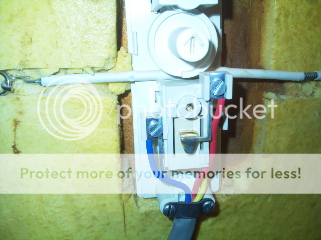

L3 Black (with a bit of tape on it !) Goes to No 1 on Cylinder stat
If i remove the pump live (No13) and the cylinder stat call (No14) which is how it has been done then the programmer isn't really doing alot?

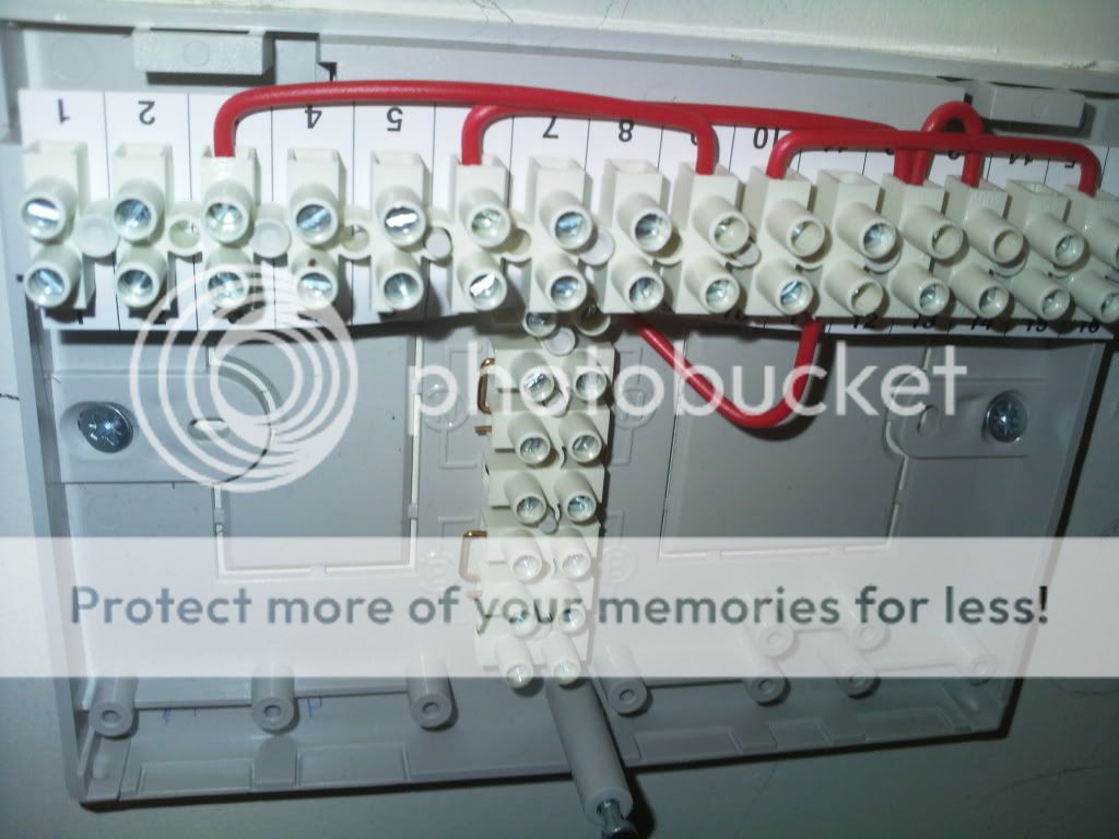

1st connector:
Red Pump
Black L2 Boiler
2nd connector:
Yellow 1 cylinder stat
Black L3 Boiler
Orange Mid pos valve
3rd connector:
Blue 2 cylinder stat
Black 1 programmer
Grey Mid pos valve
4th connector:
Red Common cylinder stat
yellow 4 programmer
5th connector:
white mid pos valve
red 3 room stat
6th connector:
Earth 2 programmer !!!!
Red live room stat !!!!
7 connector
Neutrals
8th connector
Live in
red L1 boiler
red L programmer

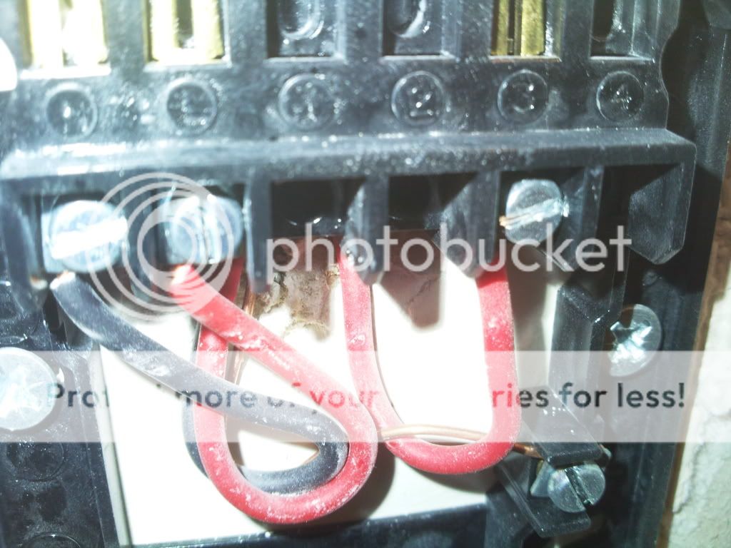

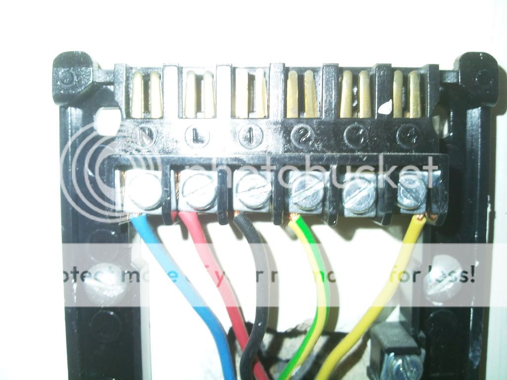

Here are some pics :D
Boiler connection
Room stat
Cylinder stat
Programmer
Earth wire No2 in programmer to live in room stat?
Wiring center
New programmer
New wiring cemter
Your problem looks to be the programmer wiring.
black to 1 - correct
Green & yellow to 2 - wrong, should go to 4
Yellow to 4 - wrong, should go to 3
the rest appears ok.
Just sat and had a look through the wiring diagram and that makes sense :D

Just checked you're on a Y plan! L3 should connect to 1 on cyl stat, and orange from valve. L2 is pump live, I ran a cable to the boiler position as its remote from the cylinder cupboard, then joined it to the flex supplying the pump via the wiring centre.
