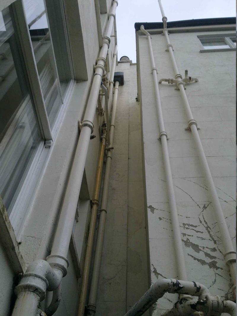

Anyway, here's the hopper as viewed from ground level:

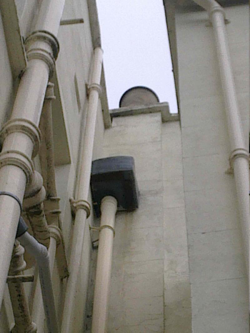

Close up of hopper (also indicating the height of the parapet - the hopper is roughly flush with the leaded gulley):

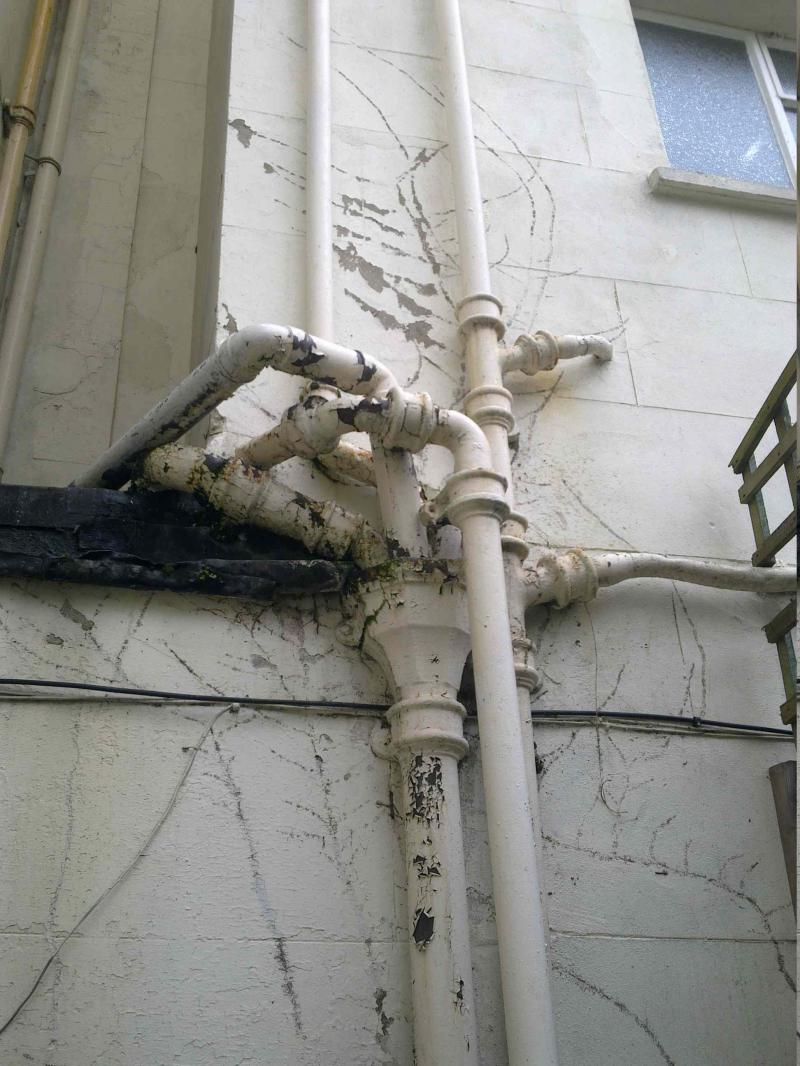

None of these pipes or the gulley are leaking, but it shows how complicated things can get further down :

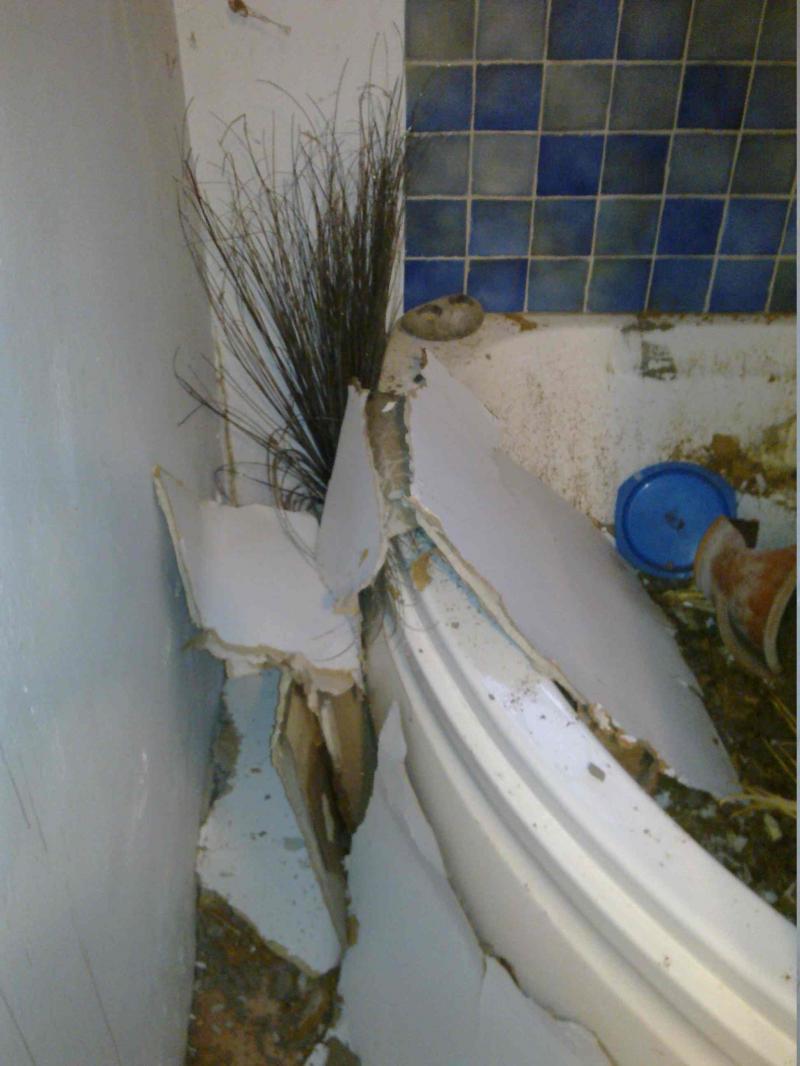

Finally, this is what can happen if you have a regularly overflowing hopper cascading the whole surface area of a big regency house 40-odd feet down onto a small flat roof (this is the state of my bathroom 2 days ago when the ceiling collapsed):
The last picture is also why I am trying to find a better solution, or advice about hopper types and sizes, or better methods to prevent build up of debris in the hopper.
Are you confident that the pipes are not blocked?
Which hopper overflows, the upper one or the lower one? Because, as I see it the upper feeds into the lower after a couple of 90 bends. A favorite place for blockages.
If the original design was so in-efficient I think it may have been changed by now. Perhaps any additions may have caused the problem rather than the original layout.
It's the upper hopper that overflows when it is clogged up. When it is clear, the water runs beautifully down the pipes and into the drains. The problem only occurs when the hopper is blocked with leaves/twigs (or in one case, a bit of old felt or plastic or something that one of the roofing contractors left behind).
